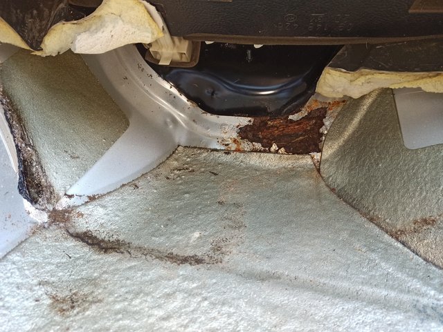

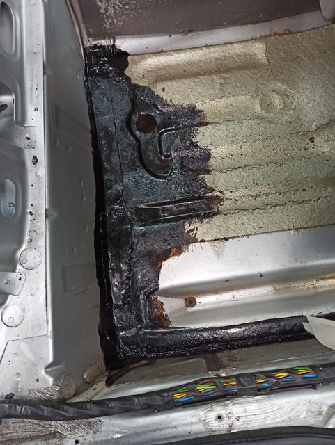

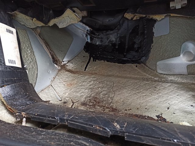

Right away the work started. As any Omega, this one had some rust problems. What I've learned in almost 10 years of Omega ownership is where to find the hidden rust.

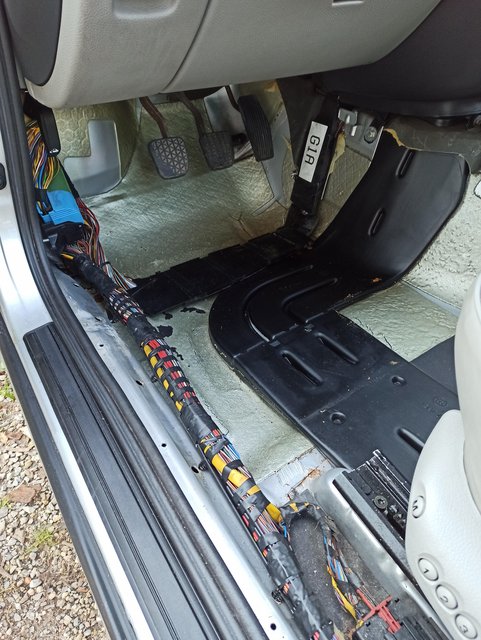

If your Omega has foggy windows look for this in driver/passenger side footwell
And fixed with new metal welded in

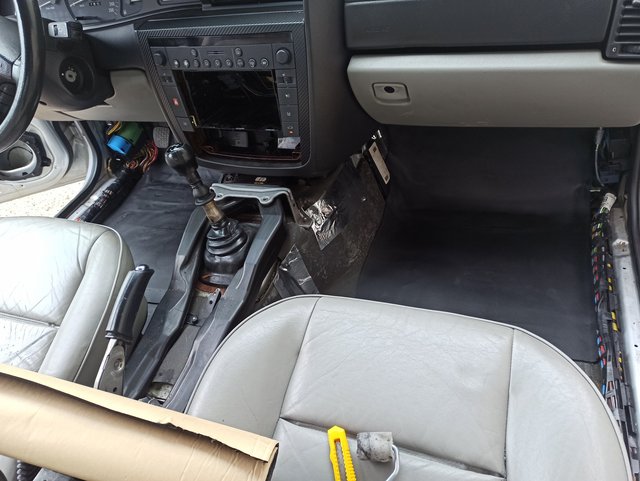

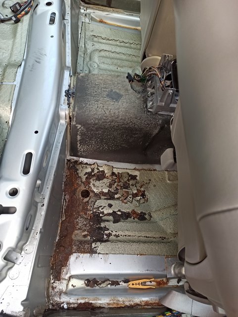

Removing the carpets revealed another spot
Repaired, new plate welded in and protected

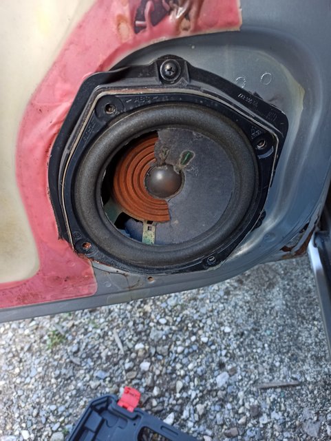

Spare wheell well was also rusty - repaired with new and protected

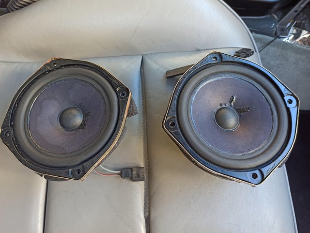

Front Bose speakers were fubar but I found an audio repair shop that was able to repair both

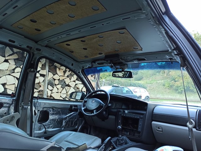

Saggy roofliner repair
It looks like this now

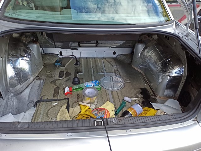

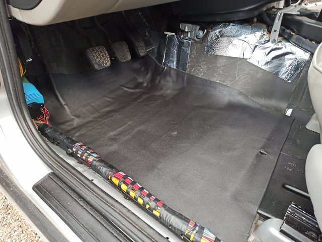

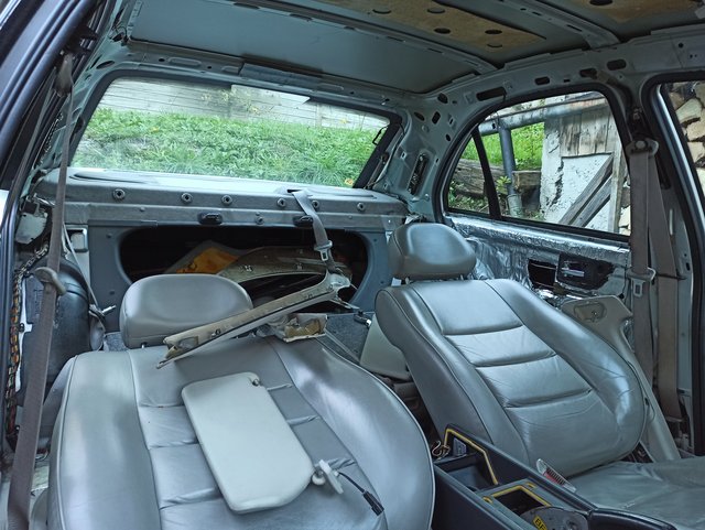

Repairing and adding some sound insulation after I cut it out to check for rust under

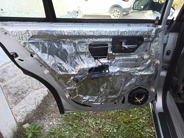

Some sound deadening material was added inside all doors

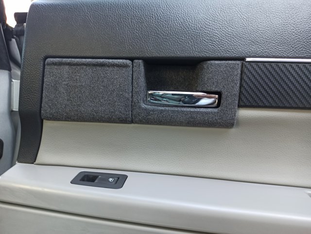

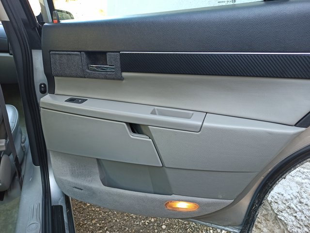

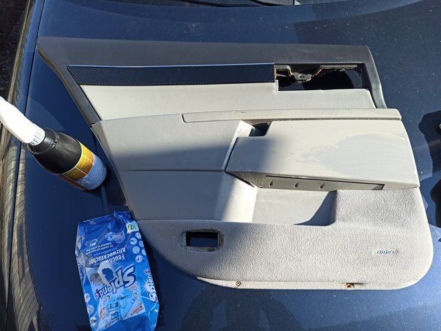

Cleaning the sticky rubber from doorcards with degreaser and cleaning wipes went really easy. They look brand new now
Plastic under door handles was flocked due to being scratched and I think it came out nice

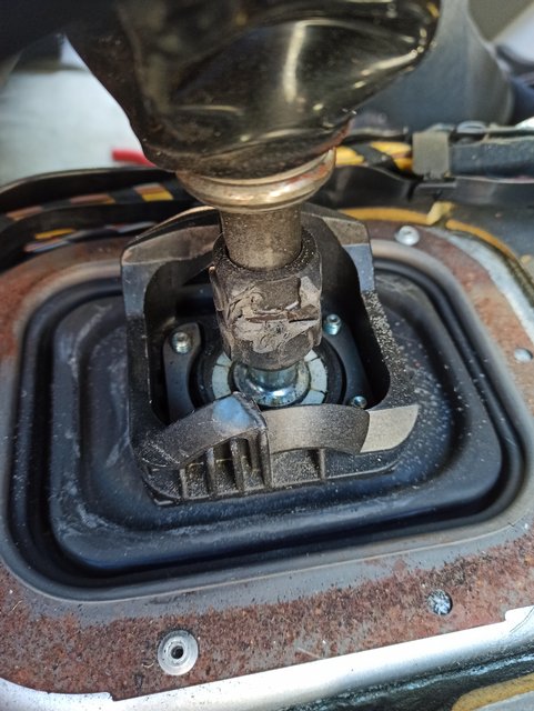

Reverse ring broken? Can't get it into reverse? No problem ::)

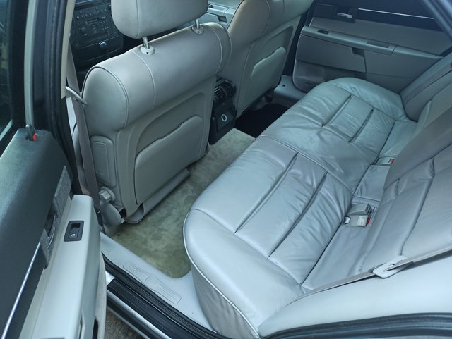

Well, she looks nice on the outside, this is the interior now
Rust work is done, interior is done, I have some new goods for her allready but they need to wait until the lockdown is over :(
I think that's an excellent solution. If it were mine, I would also flock the 'carbon fibre' trim that runs along the rest of the door so that everything matches. On the dark colour interiors this would require a keen eye to spot it isn't a factory finish :y

I did some trial and error with flocking bigger flat surfaces but got mixed results. However it is good solution for smaller uneven items like plastic part on pic
