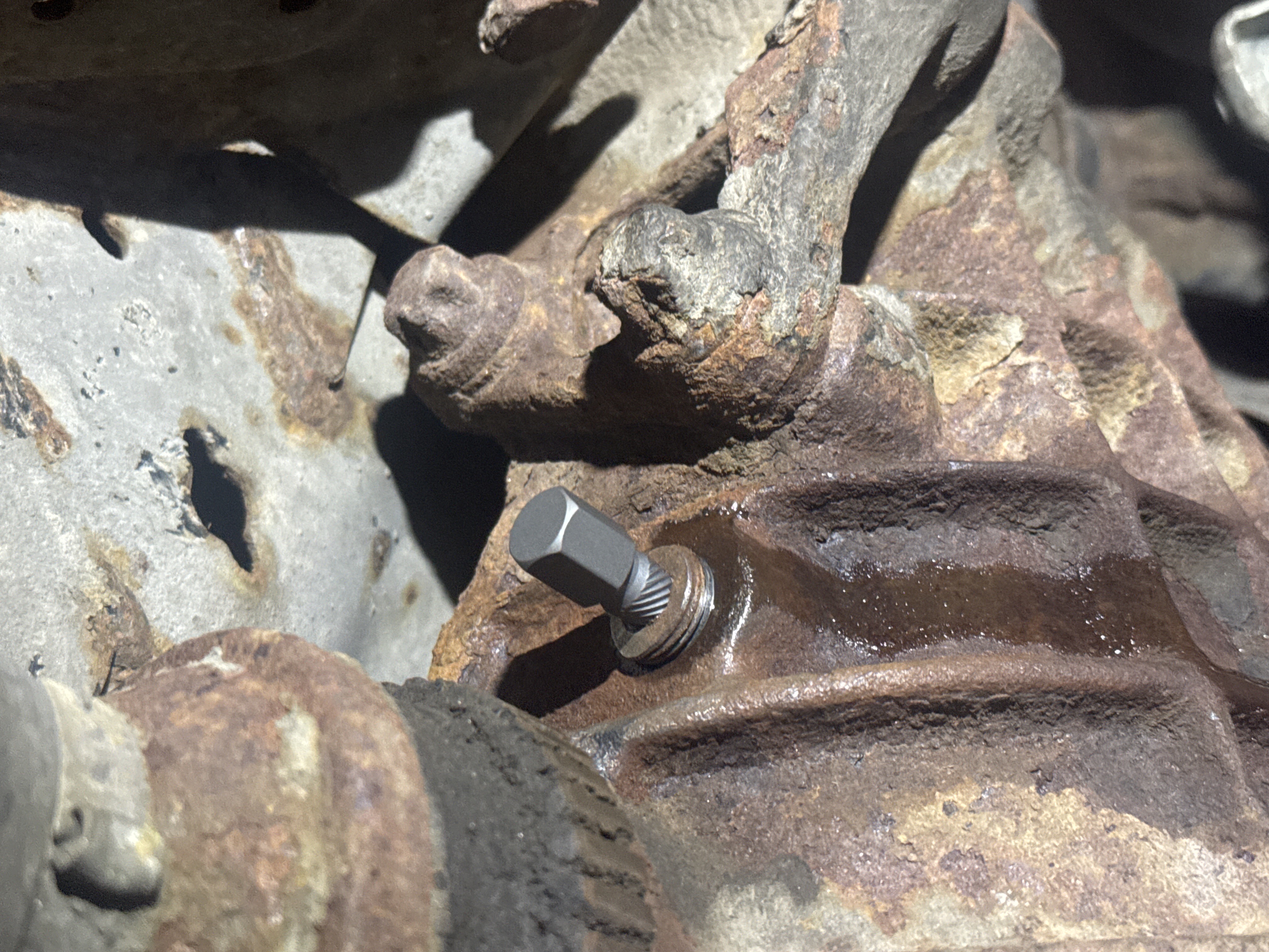

Hey. Finally got my Omega to pass MOT. Noticed that the LSD is not working, the inside wheel spins freely and the rear kind of rumbles when trying to get the car to slide. Wanted to change the diff oil with some 75w-90 LS gear oil but the fill plug is practically destroyed. Are screw extractor tools any good? Would most likely need quite a bit of bite to get it loose. I read about there being some kind of a breather hole on top of the diff that you can fill from, is there any more information on how to remove it etc.? Thanks.

Thanks for this. I checked it and it does say that this car came with factory LSD, option code G80. I ended up getting the plug out with a screw extractor set, had already put my MMA welder ready if need be. Bought some Mobil1 diff oil with the LS additive already in it.

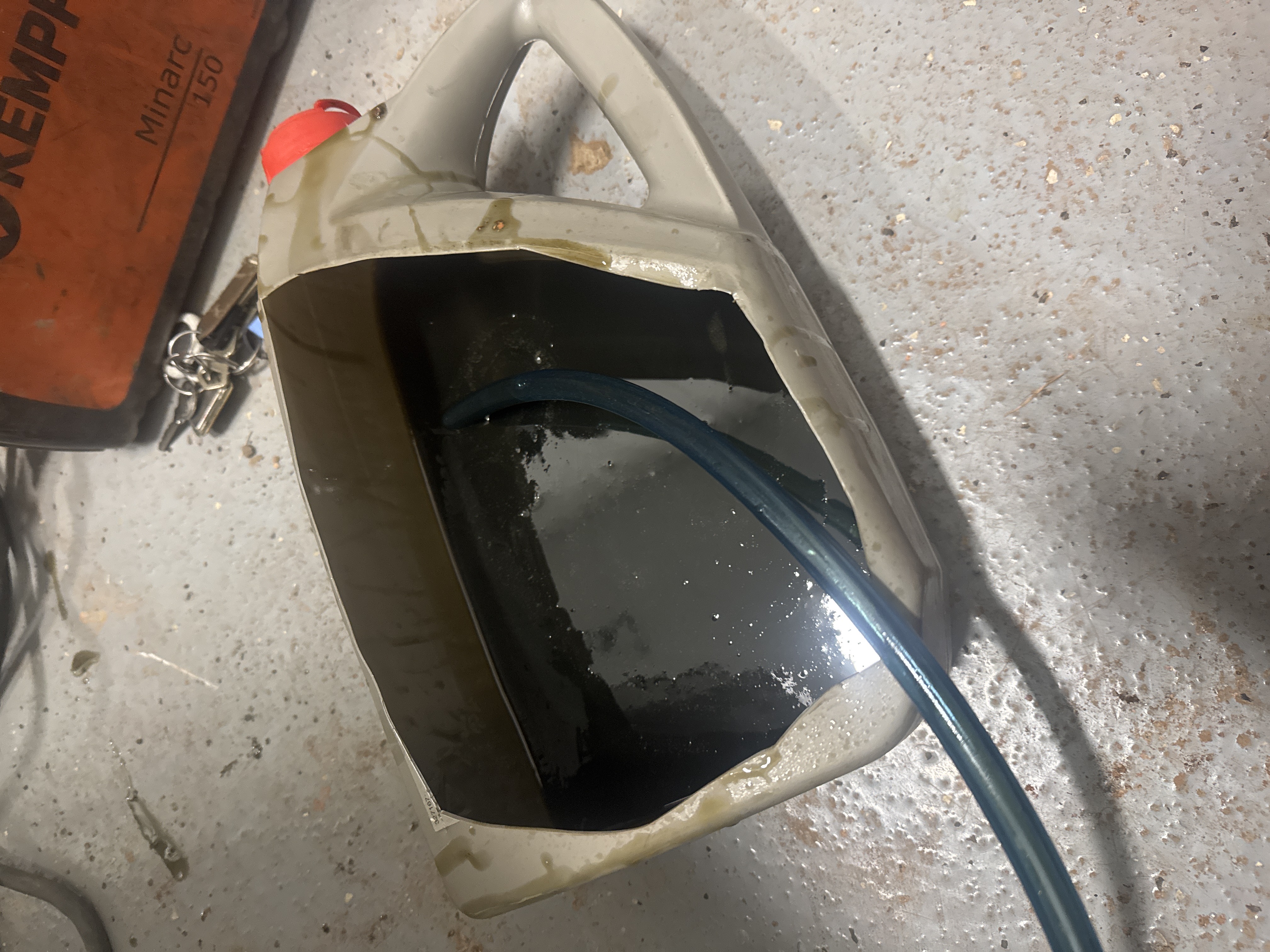

Here's a couple of pictures I took in the process. I'm 99% sure that the diff oil inside was original. It's fun reading guide articles from this forum that were written 10-15 years ago when the car was practically brand new and rust free, everything should come off nicely and without destroying the thing that you're trying to remove. Anyways, the LSD seems to be working again, which makes me happy. Now off to fix the next problem, no heat from the climate control.
Page created in 0.032 seconds with 18 queries.
