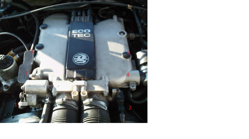

hello all, would just like to double check on my car as i have changed the dizzy and ht leads and want to make sure i have put the leads into the correct spark plugs :y
does anyone have a diagram or a picture of some sort that shows what number each cylinder is??

the diagram is actually embossed on the cam covers ;)
note also that the disspac doesn't run in the same order so double check the right pot is linked to the right disspac port. diss pac also numbered ;)

we havent got the cam cover though  :'(

« Reply #3 on: 03 May 2012, 23:16:52 »
cam cover...
5...6
3...4
1...2
front.

« Reply #4 on: 03 May 2012, 23:21:56 »
