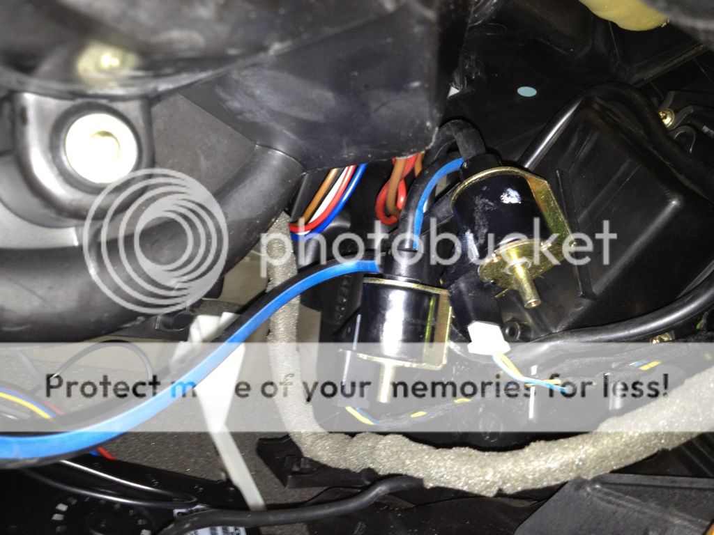

Hes done it!! Syme fixed my Miggy!!  :y
i popped round earlier and this was the state of my glove box area  :o
if you take a look at the far right hand side Solenoid, one of the vac cables was stuck behind the solenoid and squashed to oblivion!
was that right Syme??  you know me, you work miracles and its all milk bottles to me mate!! ha ha
anyway, theyve all been made accessable and not squashed up :y
and as of now, my heating is working better than ever! and it changes HOT to COLD and back again with ZERO problems
and no error codes either! now that i have Vac, she flys! got 121 mph on the A420 on the way home! Shhh!!!!!  ::)

So the heating fault was behind the glovebox ::) ;D

yes yes yes oh Jamie! it was behind the glovebox  :y
all bow before you, ha ha ha
amazing how a slightly trapped VAC pipe can ruin your life aint it?  lol

the one thing I still cannot figure out--how it got like that in the first place??? ???

i still reckon that about 8 years ago, shortly after a Nokia bluetooth kit installer bloke came round my house
he MUST have done it!!!! now.... where is his number so i can shout at him!!
The weird thing is, the heating was fine for 2 years after he installed it lol

Does look like a bodger has been in there, so mobile fitter is a sound bet, I reckon. ::)
