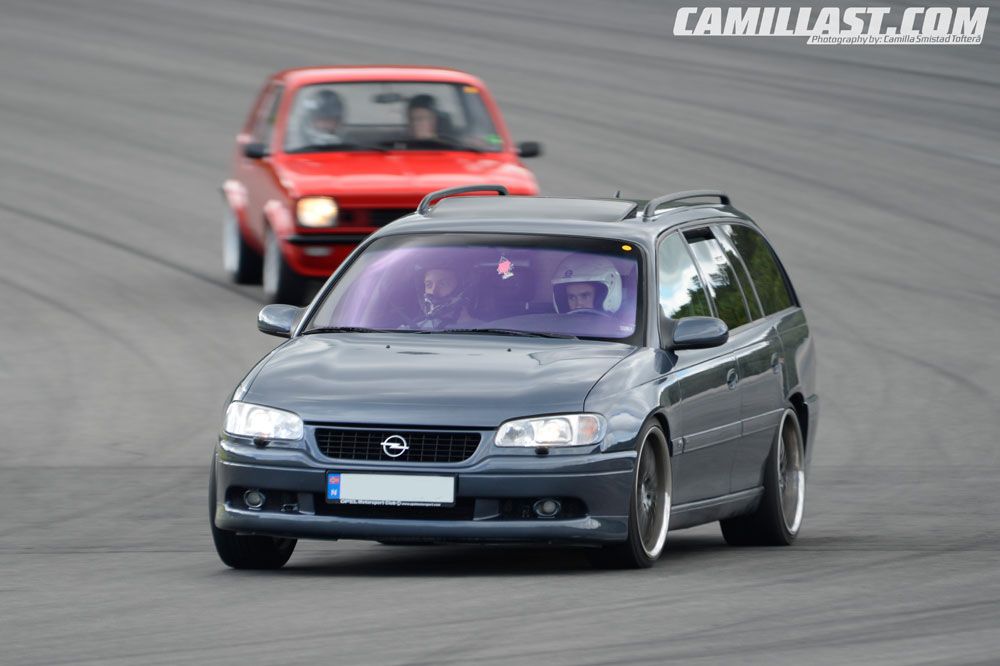

My car is lowered about 30mm if not more, and there's no problem on the normal road, and if you have low profile tires you will destroy the rims at potholes so they're a no no anyway, the only place it was a problem, was on the track in the fast corners ;)
I have fitted 20mm spacers at the rear, there was no difference except for the looks of the car (not fittet on the picture)
[picture snipped]
Crikey Andy, how wide are those rear tyres? :o
Andy89
  • Norway
  • Posts: 248
    • 97 3.0 MV6
Re: Suspension/Wheel Spacers on Omega MV6 3.0 - Help appreciated
« Reply #7 on: 06 February 2013, 21:39:45 »
265/30-19 on a 9,5" rim :)
