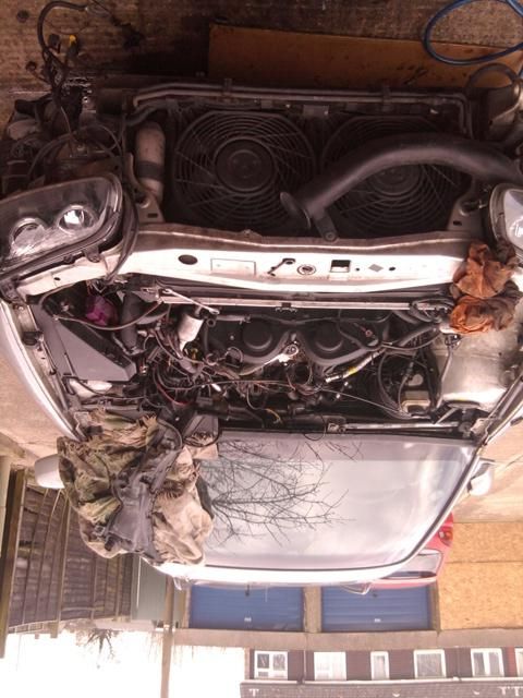

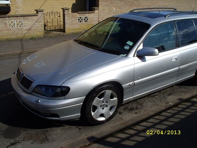

as many have seen my thread-good friday - I wrecked my mig at 243000miles so got another engine-£200(89000 miles)
well here she is before and after :y

nice job :y :y

Incredibly well done :y

Looks good :y

All credit to you,,well done looks great. :y

OMG :o
That's amazing pal  :y

Some blood and sweat has gone into that. Superb.....

I take my hat off to you and baker Stu. It looked like more than a weekend's work. Congratulations.
I assume it goes now.
Did you remove and replace the engine with gearbox attached or without?
Terry

only took engine out-easier to shift about :y unless you really want to convert to manual as auto box is heavy I would drop auto under car BUT fit manual to engine BEFORE fitting :y
and yes we started on good Friday at 1300 hrs and finished Tuesday midday :y
will strip old engine to make coffee tables from :y :y
