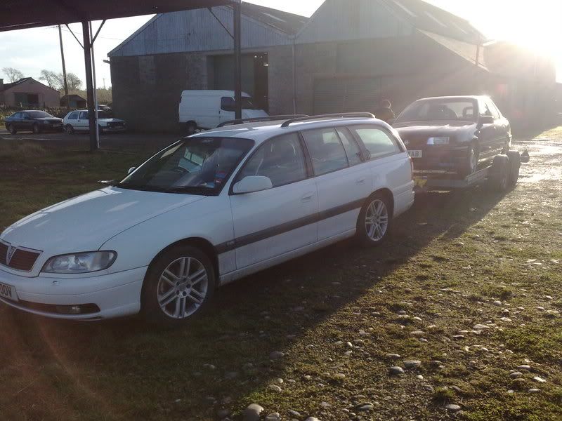

 In 2005 I bought an Ex-Lincolnshire Constabulary Omega estate 3.0 v6 manual from Paul Mimmack Cars in Blackpool with just 101,000miles on the clock. This was to be used as a general hack and dog carrier to keep the toys clean. However as time went by I really began to get attached to the old girl, and despite by far being one of the roughest looking cars Ive owned (no reconditioning had been done, ariels still in the roof, rusty tailgate etc), it was just truly an epic car. I spent a little tidying it up, painted the roof & tailgate, fitted some Vectra SRi alloys and got some MV6 Recaros's & roof rails.
 She plodded away for 4 years, done pretty much anything it was asked, and spent a large amount of time hooked up to a Brian James trailer towing cars all over the place.
 Sadly despite having been hassle free through the 4 years the time came where the full exhaust system required replacing (which was around £1k), it required a rear ABS sensor and a few other bits.......stupidly in early 2009 I decided to scrap the car and bought a Vectra SRi estate instead, a decision I still regret to this day:

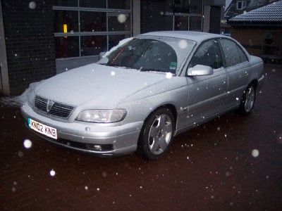

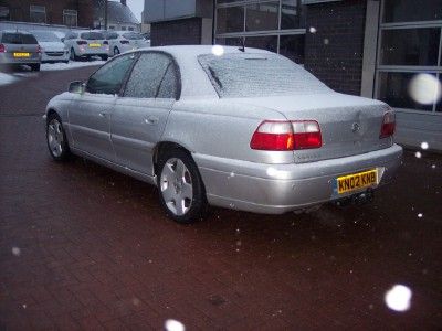

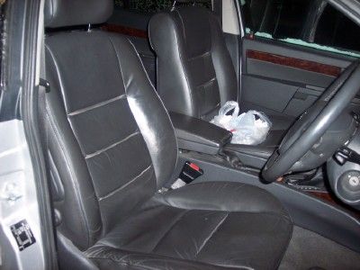

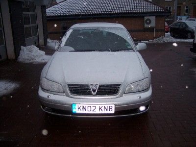

 So here it is, a 2002 Elite 3.2 Auto saloon, 123,686 miles, 3 owners from new (Vauxhall fleet management 12months, Drive Vauxhall 12 months 1 private owner since). It has full black leather, Sunroof, Sat nav & Bose system as options its a little rough around the edges but bodily is solid and is a great base to start from.......all for less than £700
Heated rear seats:

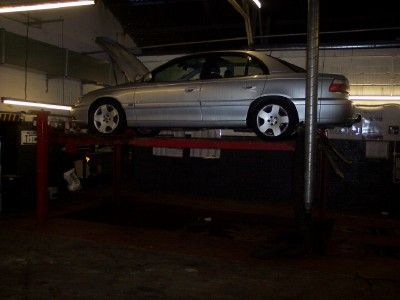

 Into work she went and onto the ramp:

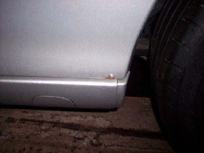

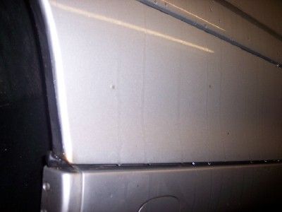

small bit of rust on the near side rear door:
off side rear door has soome blistering starting

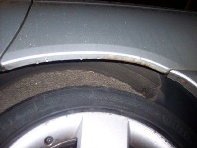

near side rear arch starting to go a bit:

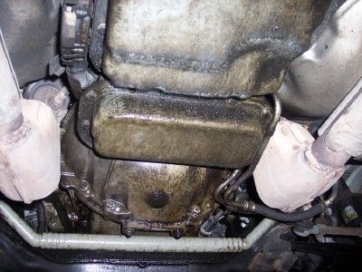

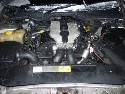

Has an oil leak from the cam cover, atlest the gearbox wont rust

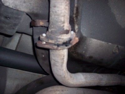

It had both sentre sections replaced recently and there is a slight blow where the left bank cat is bolted:

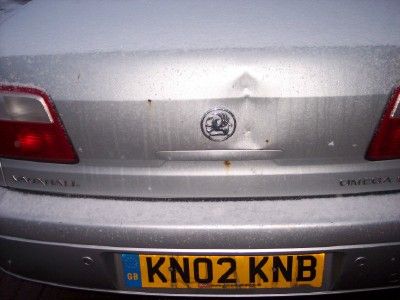

Tailgates....well its fooked, however the garage it was bought from assures me if I take the trim panel off and give it a few chaps with a hammer it will come out perfect.....eh naw:

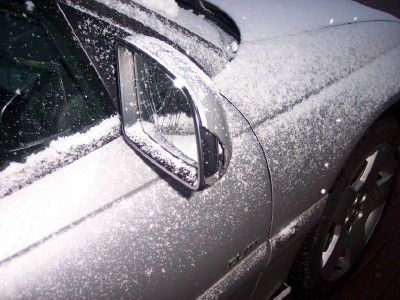

Off side mirror broken

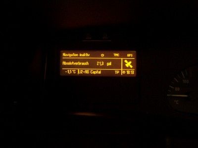

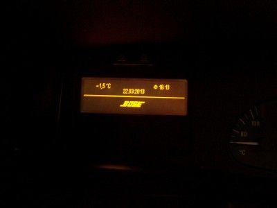

Sat nav & on board computers in German

Sat nav in German - now sorted despite the manuals lack of help

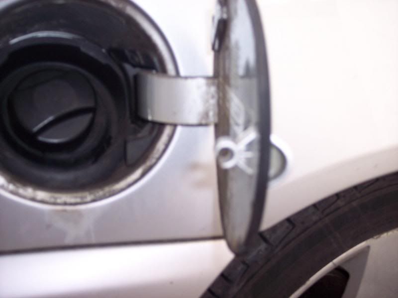

Fuel flap broken
Tailgate dented

Near side rear door rust

Offside rear wheel arch little scabbing
Near side rear wheel arch scabbing

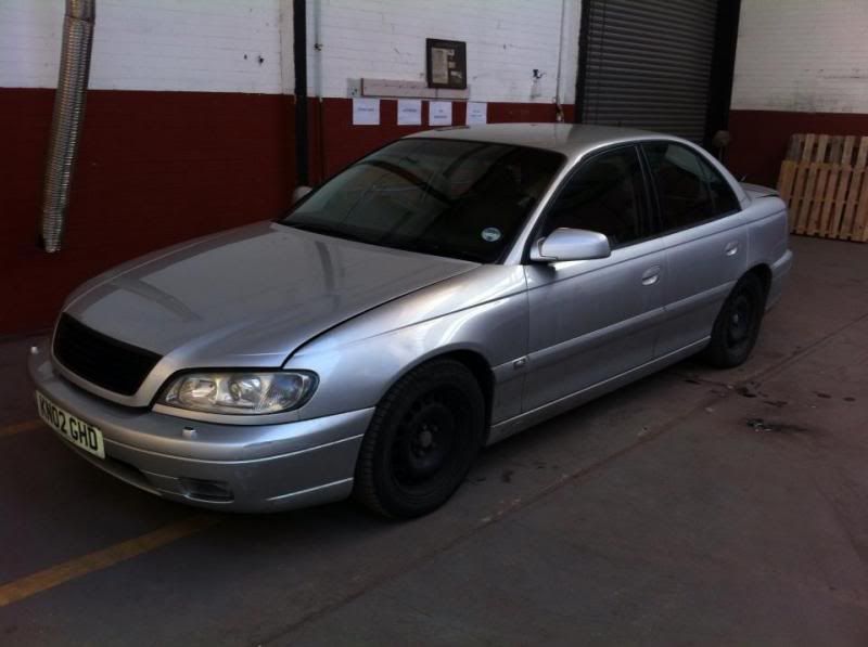

So the question is, when you have one Omega what do you do........well you buy another:
Picked this 2.6 V6 MV6 manual up last night for not a lot of pennies. The steel wheels make it look more sheddy than it is. It does come with the origional MV6 alloys and has the full leather Recaros as well as some coilovers.
 This one is not here to stay however, its purely as a donor for the Elite. The likes of the coilovers will all be sold off and hopefully should cover the cost of the car.

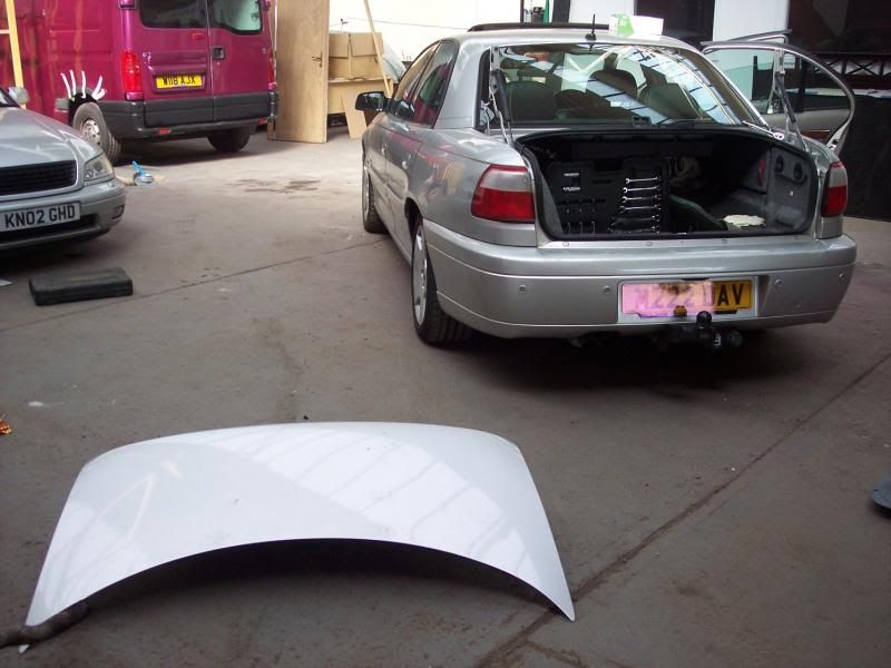

Made a bit of progress with a free afternoon yesterday:

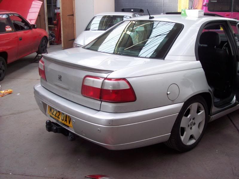

 First off it was time to get rid of the old damaged tailgate and swap it with the one off the donor car (which being an MV6 also had the Prodrive lip spoiler),
 Old tailgate off:
New tailgate on:

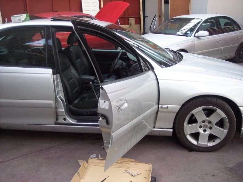

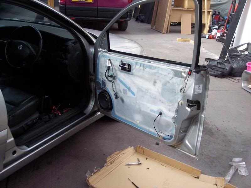

Next up it was replacing the wing mirror as well as trying to re-secure the door card and look at why the locking on the drivers side was not working as it should:
so door card off:
Wing mirror off:

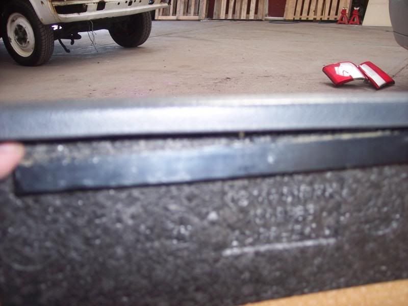

So had a look at the door card, it appears this one has been off previously, there is a plastic strip runs along the lower edge of the door card, with age the glue that holds this on has dried out and flaked away:
 Have made a temp repair with some silicone sealer, however Ill be buying a glue gun and removing all the door card to re-do them.
 Also appears that the solenoid for the door locking is faulty (given someones been in this area before it was the suspect), rather than mess around swapping it at the moment Ill hang off as the full door from the other car will be swapped over at a later date as this one has some rust under the bottom door seal.

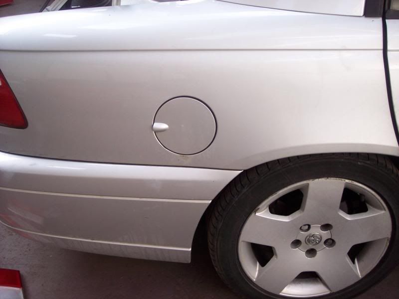

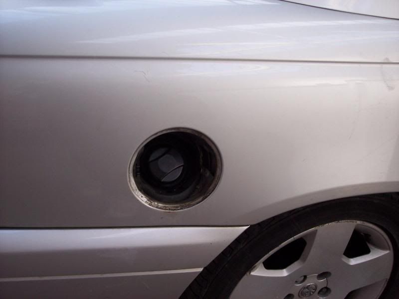

 Next up the broken fuel flap was swapped:
and fixed:

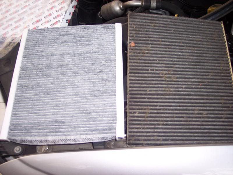

and finally I replaced the pollen filter:
