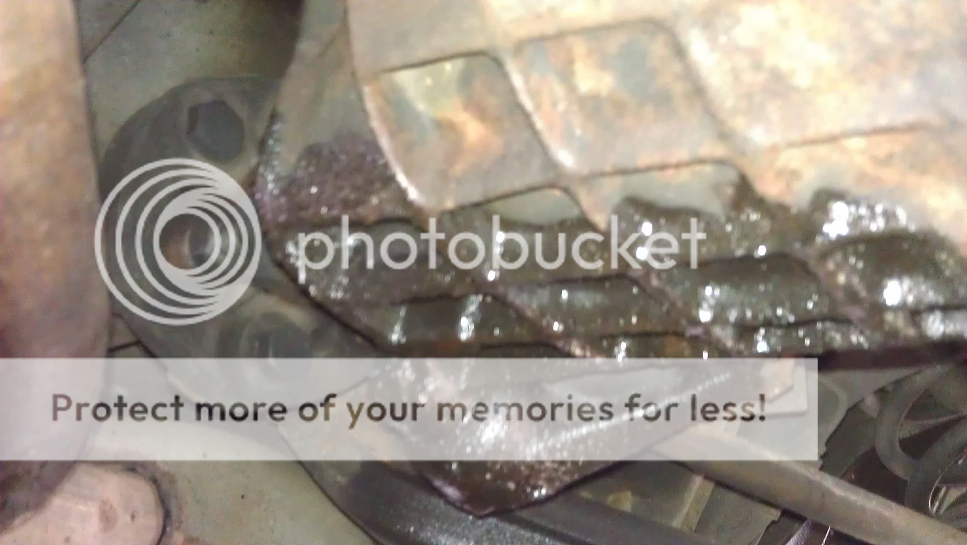

Well a new cat back exhaust is on it's way, but while investigating as to whether I'd truly gotten a full life from the exhaust or not, I noticed this:
Notice the leak on the pipe itself?

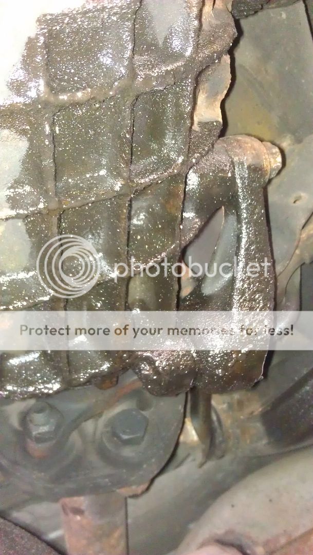

Upon further quick investigation before work this morning..
The MOT is on the 28th is a leak here problematic, and is it easier to fix without the exhaust on as it's coming off anyway?
The bizarre thing is that the MK2 cav I have just re-commissioned now needs gearbox oil seals too..
Any heads up of the likely cost / issue here?

well im looking real hard but all i can see is a differential? i think :-\

Yeah it was all the oil and the pool on the floor - what's involved / likely leaking was what I was wondering about!

Looks like the diff pinion oil seal has sprung a leak (not uncommon).

Not a problem for MOT.
Keep the diff oil level topped up and see how much it's losing, I'd say. Not a difficult job but needs care to keep the preload on the bearing correct. There's a maintenance guide, I believe.
