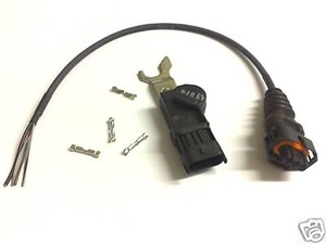

The GM cam sensor used to come with a new length of loom, what shape is the connector?

It is oval to suit long neck of sensor but it is a kit of parts nothing at all assembled and as to location of the six leads !!!!!!

The ones I have used in the past look like this:
Do you have a pic of what you have got

« Reply #9 on: 05 September 2013, 17:14:44 »
Not like that no pics as gave it all back for refund

Plug looks same though
