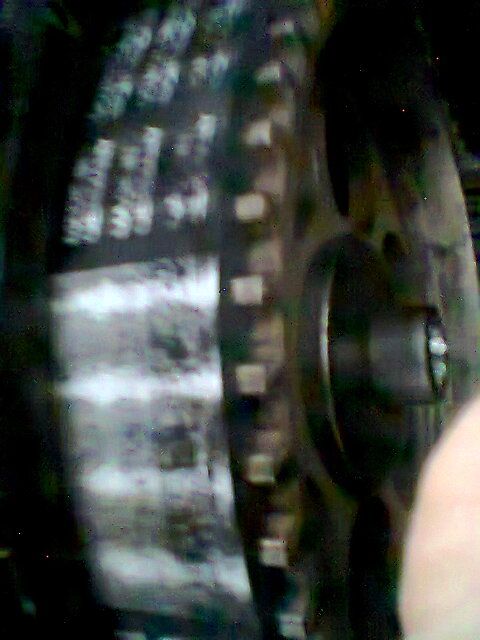

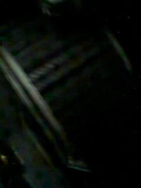

one final thing (sorry I know i'm annoying)
heres day time pics of the belt on the sprockets (although still shite quality - note to self, buy better camera). I trust this is normal... the belt to be quite far back on the cam sprockets and the belt to be as far back on the idlers as they'll go....tried to get a piece of paper down the back to make sure there was some space but I couldn't get the paper to bend down at the back. very tricky. was just trying to validate that it wasn't touching the rear cover. I am fairly confident i'm worrying about nothing but its nice to know that I've covered every avenue :)

Clearly you failed to remove all the biits of shredded belt.
I have heard a slight squeek where the belt makes slight contact with the cover on add occasions, normaly slackening the cover botls and re-positioning it slightly sorts it
