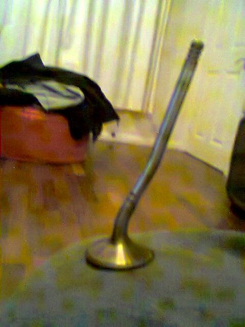

oh and at lunchen I borrowed the valve spring compressor to get my valves out of my cylinder heads...fairly sure the valves aren't meant to be like this ...  ;D ;D ;D ;D ;D ;D
bad bit of news is that the valve guides are all cracked  :'( so ill knock them out and have to have them replaced

I don't think Ive ever seen a valve bent quite like that.  :-\ ::)
Webby the Bear
  • Northampton
  • Posts: 12763
    • 2000 (W Reg.) 2.5 V6 CD
 ;D
my teacher said that also.... he said that normally they're either bent slightly or they bend like mine and break.  :-\
RIP Paul Lovejoy
Thats some shaped valve mate - have you tried straightening it yet?  ;D ;D ;D ;D ;D ;)
