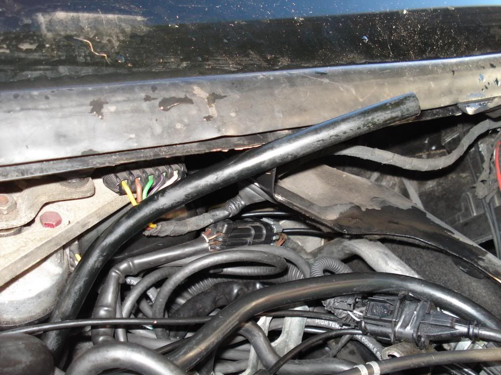

ps any idea what diameter hose the gearbox breather is? going to go searching for it in a few minutes... if I recall its quite a think one isn't it?
RIP Paul Lovejoy
Re: Diff fluid top-up
« Reply #17 on: 17 December 2013, 12:52:42 »
No its a thick one , you cant miss it  :D

one trusts this is the gearbox breather? :)
RIP Paul Lovejoy
« Reply #19 on: 17 December 2013, 16:05:15 »
Yep. :y
