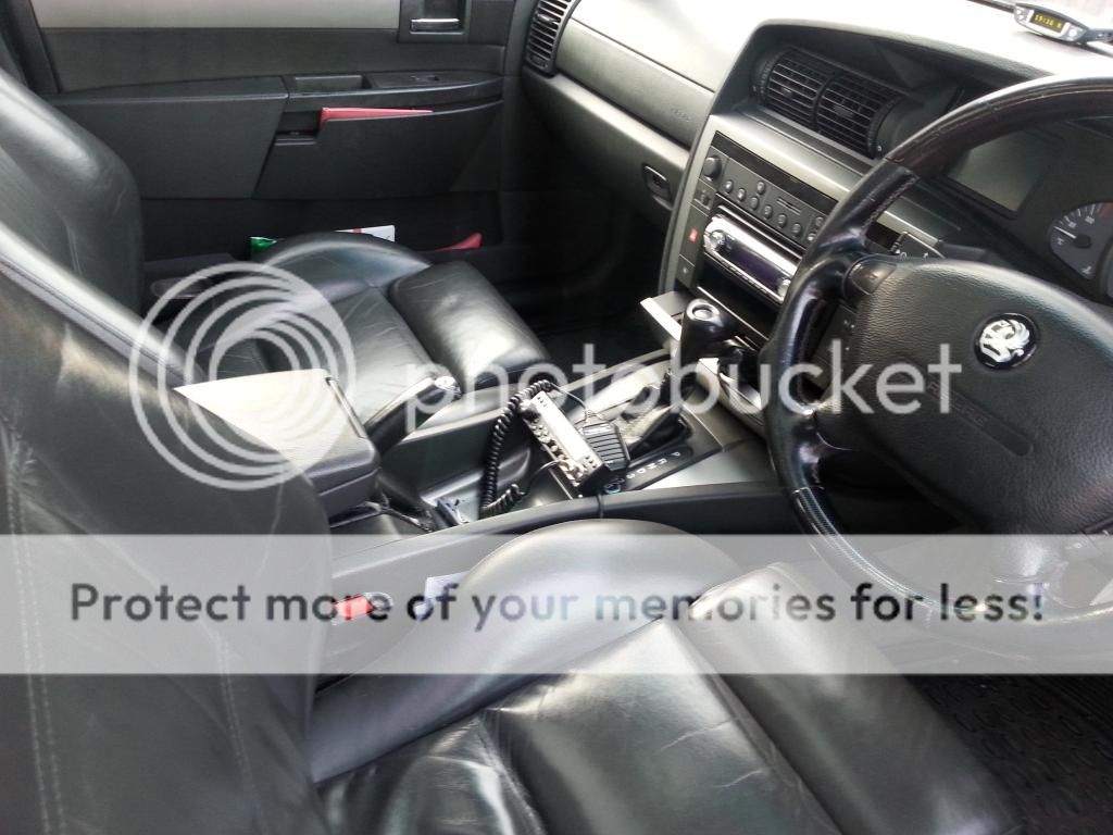

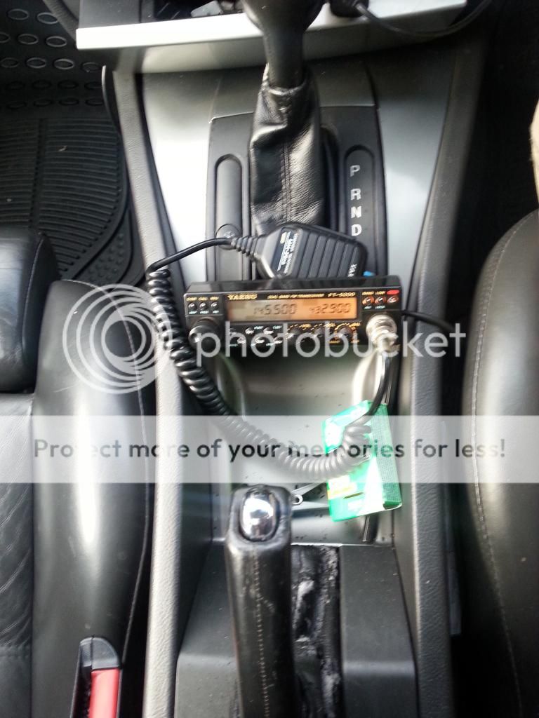

Well I found a place to install it :)
The head unit itself..
The radio body... yes I know the wires are a bit untidy, I'll be sorting them out tomorrow :)
And the H/U without the radio controls :)

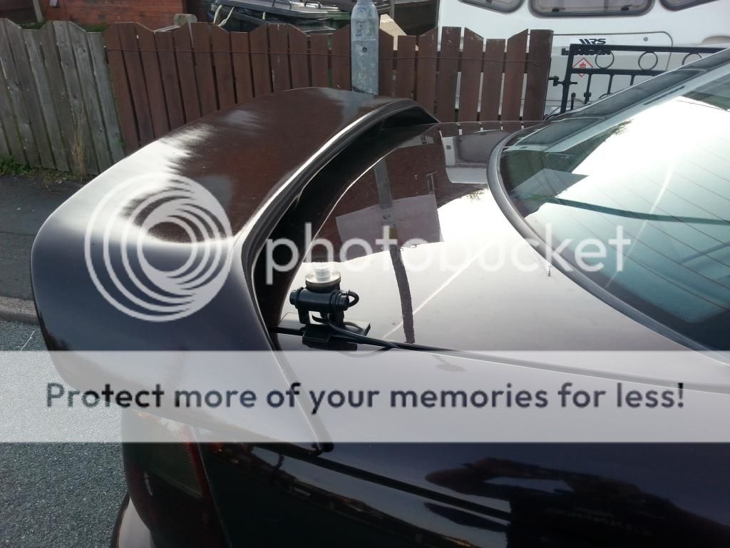

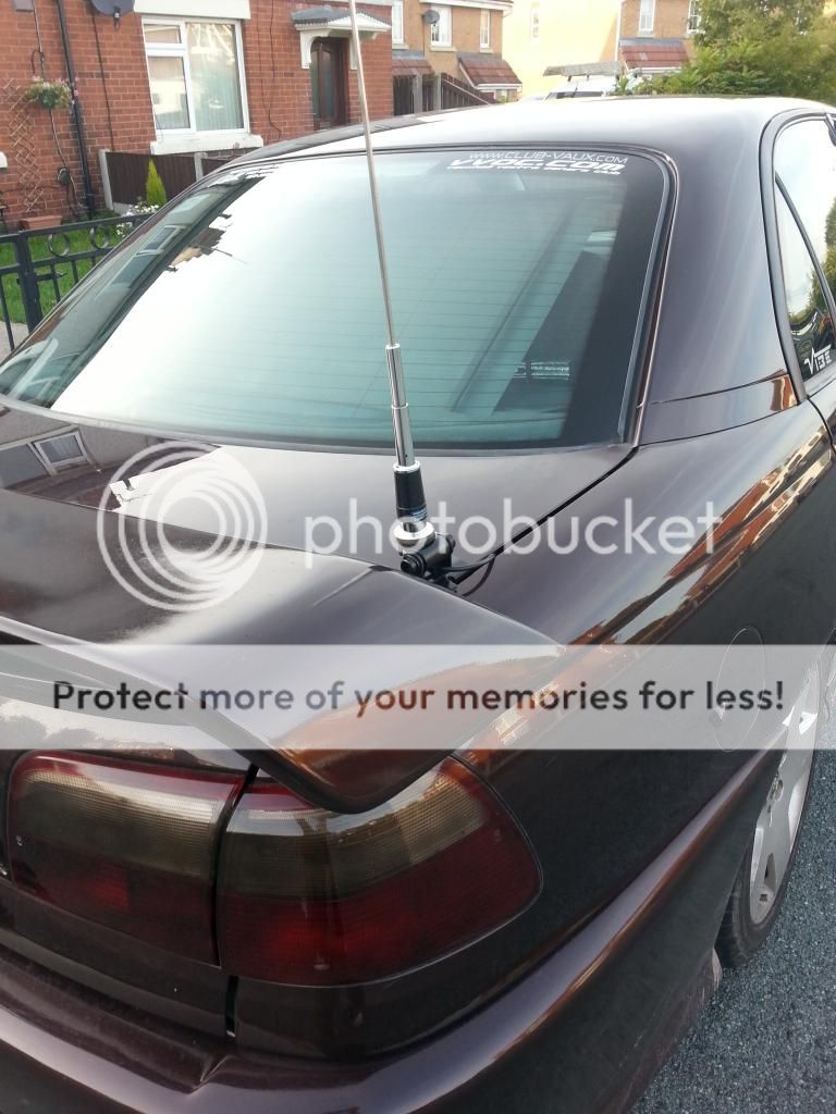

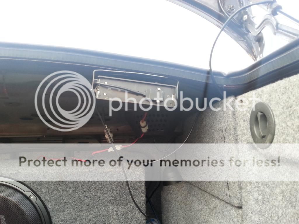

My next problem was the antenna fitment, do I buy an expensive glass mount antenna - which work extremely well, or do I buy a bodymount antenna base... I went to my localish radio supplies shop (not Maplin a proper radio supplier) and they had no glass mount antennas in stock so had to settle for a bodymount/bootlid mount antenna base :)
Im all happy now that my 'rig' is back in my motor and it can be used when I want to :)
Thanks to all for any suggestions, but I settled on the bottom of the gearshift surround as I reckoned there was plenty about in scrappies etc.. if I need to replace it for some reason :)
