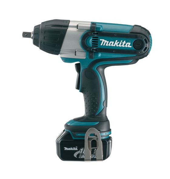

Evening guys, one trusts you're all well  :y
So. After I posted a thread looking for advice on the best cordless impact wrench I chose one......
The tool is expensive (£379 inc. VAT) but as stated in my previous thread I was left some money by my gran so wanted to make some good investments with it.
So, the tool comes with 2 X 18V/3.0AH batteries (fortunately my batteries were upgraded to 4.0AH as they were out of stock of the 3.0AH ones  8)). It also comes with a charger with different lights on to indicate at what state the charge is at. It also of course comes with the body also.
The wrench is quite top heavy. I used it two days ago to do my shockers and it did become a bit wearisome with that weight. It also comes with a belt clip which to me is a bit pointless due to the weight of the thing.
However, great news is that the charging time is very short. It went from half battery (as delivered) to fully charged in about 10 minutes!
The power is immense. 110nm Omega wheel bolts.... off in a split second.  8)
I also undid the lower shock bolts with ease. These are also done up to 110nm but there was a lot of corrosion so I'm thinking they'd be more difficult to undo. EASY  :y
So, as a verdict expensive but you pays ya money..........

oh and has switch on / off light which I prefer to the light being constantly on  :y

Nick, thats a really good point re the angle grinder... didnt realise the batteries were transferable.
Really enjoying using it. if i'd have had just a ratchet and a breaker bar those shocks would have took forever.
As said it is heavy. if i was using it all day...... may get a bit hand heavy. but hey..... i get bigger paws. women like that  ::)

Just to add,  was using it for 4 hours on and off. Battery life didnt seem to be affected.
I dont have abything to try it's max. undoing power on the car. Although some of our fences in the back garden are held to a post with 17mm bolts. Might try ascending torques and see what it's really capable of and report back.
