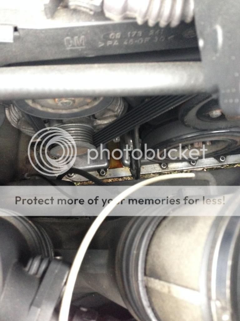

Had a car on the drive today. Dryest cam covers I've ever seen. Driest oil pressure sensor I've ever seen. Dryest oil level seņor I've ever seen. Cleanest sump I've ever seen.
Except it was covered in fresh engine oil. Top sump?
Usual sight, although not usually as clean as this.

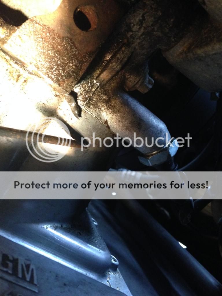

Where I think it's coming from, can just see a wash of oil from the top sump join
Similar pic but with a screw driver pointing to the area of oil seeping down, here.
I presume it's a case of supporting the engine from above and removing the sibframe?

That looks like either the oil pump rear gasket or from the front edge of the right hand camcover gasket :-\
Looking at the second pic, that gasket between the oil pump case and upper sump looks a bit battered, (the black bit hanging out)... I wonder if this has had a new oil pump without replacing the sump gasket :-\
The pump can be changed without dropping the sump a fraction, but doing it without runs a risk of tearing the gasket (if fitted) or sealant bead...
Very clean otherwise  8)
What he said. :y Or it's from the camshaft oil seals and is running down behind the backplate.

Cam cover seals are dry so not them.
Could be cam seal as I suggested last time I saw the car iirc. But, although the pics aren't as clear as I'd hoped, I'm convinced there is oil seapong from that upper sump to block/oil cooler join.

Oil pump is a gasket
http://www.partsbase.org/opel/omega-b-1994-2003-5-5-21-oil-pump-and-fittings/
Would it be fair to say oil pump removal, although possibly a cause, is not likely? In which case I'd suggest the goo in the seal from upper sump to block could do with re doing....?
