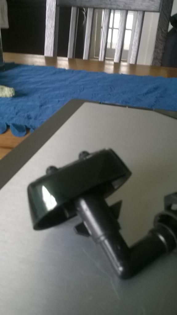

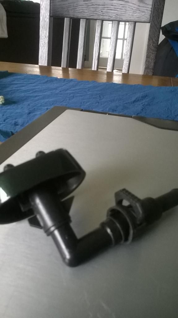

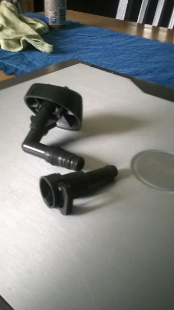

Here are some pictures of the assembly....
The first pic shows the assembled unit, you can see the quick release piece, which you press in. However, it is not as quick release as you may think ;) 'O' rings hold it quite tight !!
The second picture shows the tabs that the plate slides over to hold the unit to the bumper.
The third picture shows the unit apart, clearly showing the release clip, and the two 'o' rings
If you can manage to clip these apart under the car,  there is no need to play around with the feed pipes.
The car needs lifting (safely) just enough to give you reasonable access. Once disconnected, the jet pushes up through the bumper and is part of the housing. The jet can then be separated from the housing by carefully pushing it upwards.
Remember to fit new jet into housing before refitting (out of experience) ;D
