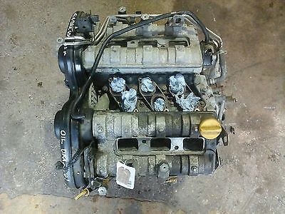

Upper photo is reason why I'm asking Al, that seem as metal covers with holes for dis pack
Re: A quick one about rocker cover
« Reply #6 on: 03 June 2015, 04:05:53 »
Interesting.. .The 3.2 in Vec C uses same covers as Omega... Presumed 2.6 was the same :-[
Ignoring the whole metal covers point, 2.6/3.2 covers will be fine and dandy :y

Good to hear :y I found a 2.6 veccy engine for 300eur just need to ask if it has metal covers and "IF" I could get those alone of the engine. Don't need another lump in the garage :P Thanks for help guys

2.6 Vectra doesn't have metal covers... Also plug leads should be a secure fit to the plugs regardless :y
As pointed out, it does. All the Vectra B V6's are metal covers. 2.6 have COP recesses, 2.5 don't.
The Signum 3.2 and the Vec C 3.2 both use plastic covers.
