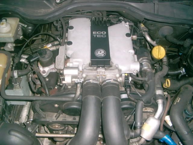

The Multi-ram, or 'Plenum' as it's mostly referred to on here, as shown below
and
is probaly what you're referring to, omegatron182?  :)

« Reply #6 on: 08 October 2015, 20:55:26 »
Tis indeed, thankyou please 😊
