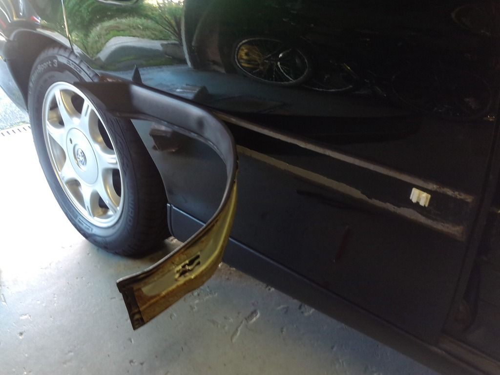

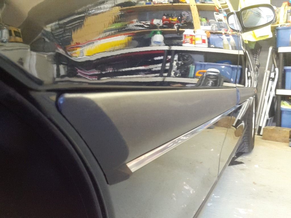

« Reply #7 on: 12 March 2016, 22:11:18 »
PFL estate
I opened the rear door of my car and this trim bit fell off. I can't see how it was attached in the first place. Was it glued on?
As mentioned metal bit should be attached to the bit that fell off !  I replaced on of mine, as the rear ones can catch on the back of the drivers door when open rear.
As below, a new ones comes with the metal strip bonded to the trim.  You simply peel off the adhesive tape cover and press on.  There are two plastic locating pins which clip into place to you know its in the right place.  If fitting new one, old one can be removed if careful, patient and take care.
Below is my before at after - I peeled the old one back more to make removal easier.  sharp flat knife at the back to cut the adhesive tape to remove final old metal bit, and then plenty of cleaning and de-grease and polish before fitting new one  :y
