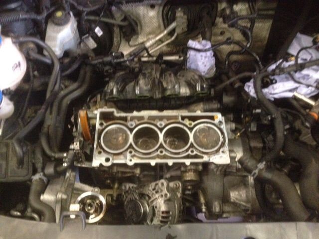

Few months back we had a Audi A3 recovered in with the above engine in. Chain slipped and shagged the valves.
Couple of months after that. Another A3 recovered in. Same engine. Same chain slippage. Same wrecked valves.

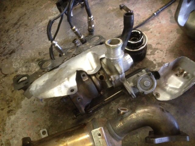

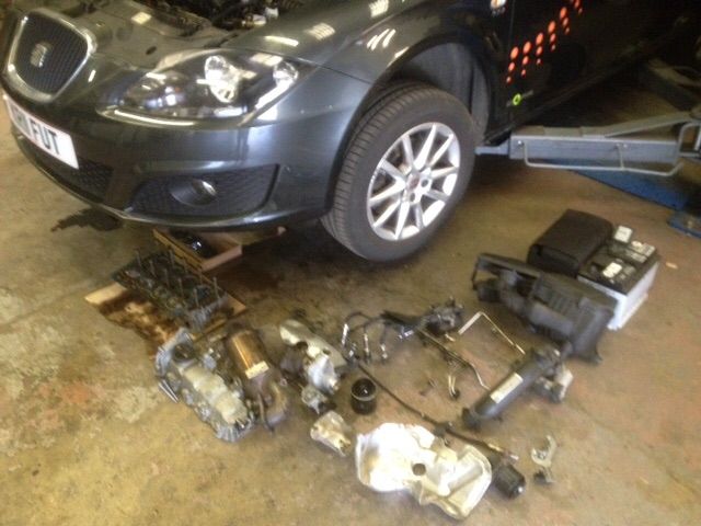

Friday a Seat Leon comes in. Same engine. And guess what? This time I've got the fun task of fixing it. I got the head off yesterday. Got to say it's a really nice engine to work on. Bags of room and will be my 4th chain and 3rd head removal at the garage. Few pics below if interested. Note the witness marks on the tops of the Pistons.
However what is it with this engine? I looked on Autogayta and there's no TSB's about this. After speaking to the customer he did say the oil warning light came on (the level warning, not oil pressure) a couple of weeks back but he topped up immediately. So is this dodgy engines or just a case of customers running their cars low on oil and paying the consequences?
Pics of progress:
