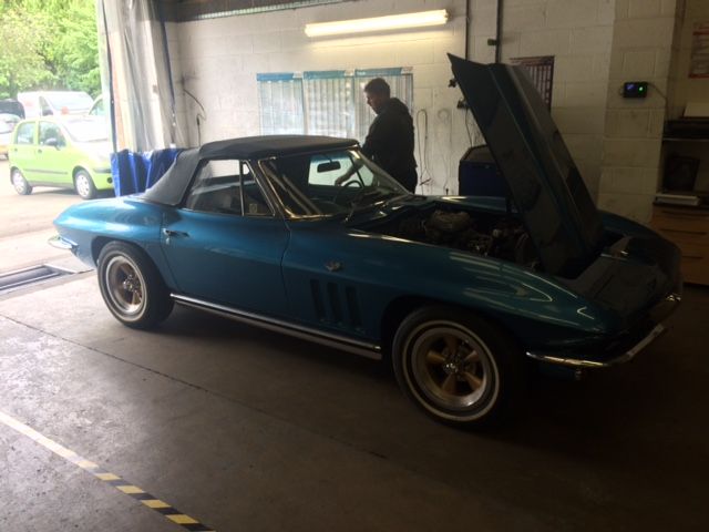

Ps, the blog wouldn't just be about mind numbing (to some) repairs. There's the occasional gem.....
 8)
Nice....what lump in the 'Vette'?

I think these were 427 cu? So an "ample" 7.0L in new money.
Bet it sounds fan-bloody-tastic :)
Edit: Regarding the blog Webby, I'd read it for sure  :y
It's a pity Chevrolet didn't make a derv Vette. I'd have been first in the queue for that beauty. ::)

Cheers boys  :y
It sounded bloody beautiful. And smells even better. Just lots of unburnt fuel  8)
It's in perfect condition.  i don't quite get it tho. It lives in a garage under a sheet for most of the year. It appears it only comes out at mot time  ???
