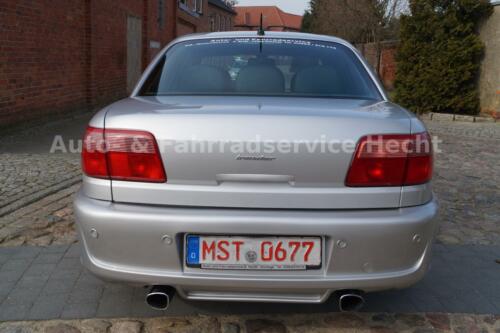

Does anyone have any documentation or decent resolution pictures of where to drill the park sensor holes in an Irmscher Saloon bumper?
I can hold it up against a standard bumper if not but thought i'd ask here first  :y

« Reply #1 on: 26 June 2021, 16:47:03 »
May help

Pilot holes now drilled, got to find a spare sensor housing now to drill the right size hole  :y

Had to order a new hole cutter as mine is too small.  ::)
Got a full set of sensors in a box somewhere so will seek them out for trial fitting  :y

New hole cutter arrived and holes drilled, trial fitted with spare Parkpilot kit I have.
Al did do a guide for the correct locations  :y https://www.omegaowners.com/forum/index.php?topic=132545.msg1698121#msg1698121

So I did ;D
