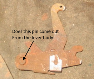

I have started to rebuild the handbrake and rear discs, on my 1995 2.0 16V Omega estate. I took the handbrake lever out to clean and grease, as suggested because it was seized.
When I seperated the leaver the pin on the one end came out. Is it supposed to be loose, or is the lever broke?  I have included a photo, showing the part that has seperated.
Thanks for any help.
Addy

« Reply #6 on: 23 August 2021, 12:52:01 »
The pin is a separate part. Its seizing is one contributing factor to the handbrake sticking ;)
Just clean andd regrease as yoi would the levers :y

Thank you DG for the quick reply. Just thought I would check, especially it being brakes.  Will clean up and reuse.
