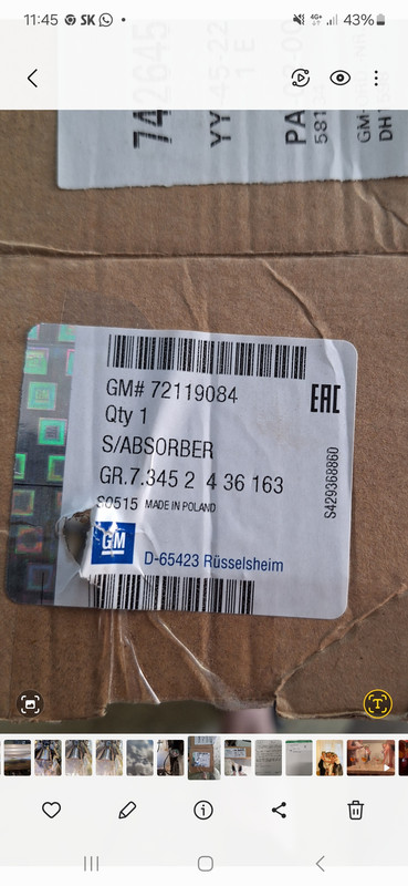

Re: Lifting the suspension
« Reply #5 on: 15 February 2025, 18:31:54 »
Actually I bought those, are they not available anymore? I bought only Monroe kit to get hoses, pressure meter etc. I try to find Monroe kit number.
« Reply #6 on: 26 February 2025, 06:00:08 »
I bought (if my memory works) Hose Kit Mobroe AK-29 to those shocks and then I have Monroe AK-10 kit includibg T as well, pressure meter and Schrader for filling.
