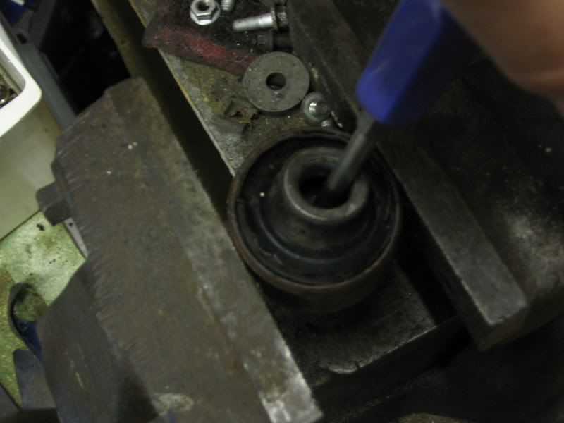

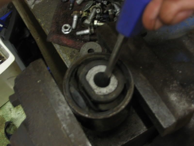

Project B has a few interesting handling characteristcis and was showing signs of wear on the inside edges of the tyres.
So, off with its wishbones!
The front horizontal bush:
The rear vertical bush:
Both are totaly cream crackered so I will check the camber etc as the next job and free off the front track rods ready for tracking setting.

Did you rebush the old ones? I did that on my old omega but it ended up costing as much as new wishbones as i had to go to a machine shop and ask them t make metal cups so that i coud remove the bushes which cost 40euro and then i realised that my dads press was not strong enough and i paid another 20 for the same guys to remove and refit the new bushes. The irony is that the local opel garage had quoted me 50 euro to do the job.
  • Posts: 34173
Re: Wishbone bushes
« Reply #11 on: 30 December 2006, 20:52:54 »
Yes I did re-bush them....with Boge bushes which I already had.
I have a proper set of guides (vaux items) for use with a press (matchless has a homemade press) so no overheads. I am sure if they were needed, the guides etc could be made available as a loan to somebody but, there dam heavy so wouldn't want to post them!

Inside edge tyre wear is possibly knackered camber, seemingly a common Omega problem. Consider a Full Geometry check (not 4 wheel alignment etc, waste of money imho).
  • Posts: 34173
Re: Wishbone bushes
« Reply #14 on: 31 December 2006, 15:32:40 »
Yes there was movement but, if you looked closely you cold see the vertical bush had split.....if the bushes ae as bad as these then the camber will be affeceted as the wishbone moves out (and in again!) and hence the tyre wear...
I'm sure these were the original 137K mile bushes.........there is little point in getting the camber set if the bushes are shot...
