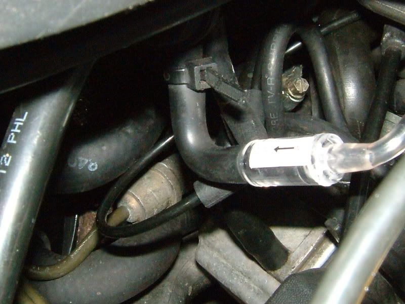

Ok. One type of valve arrived today, a packet of 3  :y.  One was much less restrictive than the rest so used that one. Connected as described, then repeated test - ta dah! Hissing when pipe removed from multiram  :y.  Will be going out soon so will see how the car respondes and will report back.

I think  "Perkier" would sum up the improvement.  Nice one Mark. Top man  :y

I was out and about this morning, definate improvement in performance  :y  so much so that when following another car on a short overtake we went so fast i almost ran into the back of him - wasn't expecting her to pull so well  :)

My engine had 2 flatspots between tickover and just over 4000 rpm where there was a definate howl and surge.This has been getting gradually more pronounced. I did the check and could'nt hear the snake,so found a non-return valve which a friend had laying on his workshop floor.Its 6mm so had to reduce it down to 4mm with a couple of adapters and Bobs your Auntie.
Flats spots appear to have gone :o and the throttle response seems alot better. No surge at 4000 rpm now either just smooth. :y

c/o Mark.
It didn't (I think someone suspected it might not)
It does now - thanks Mark  :y

I can confirm that the initial pickup, esp WOT from standing start is much. much better.

No hiss from mine, put the valve in and it seems better. Will have a better idea after another test run. Top idea Mark :y
