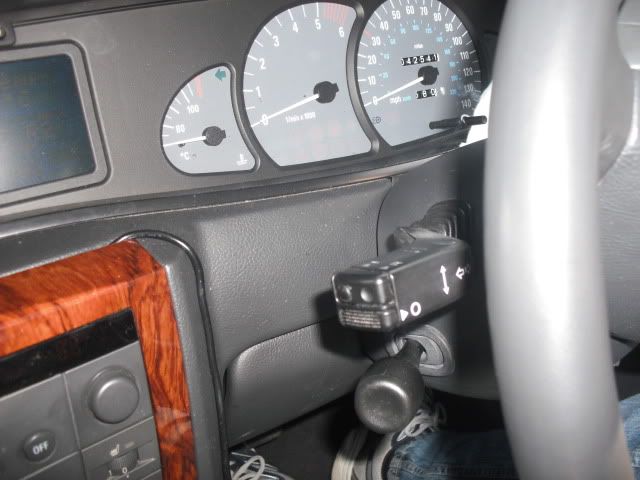

Firstly a big thank you to 'Simon Omega 2' for supplying me the Cruise Stalk.  [smiley=dankk2.gif]
Right today I got around to fitting the cruise control.

Right then removed cowling as shown in the Omega how to guide and plugged the extra lead in, refitted the cowling.
Checked that the indicators and high beam still worked ;-)
[size=16]THEN CAME THE BIG BONUS   [/size]8-)
Took the car for a test drive and it [size=14]WORKS[/size][/color] (Didn't need the TECH2 to enable the cruise)   ;D
