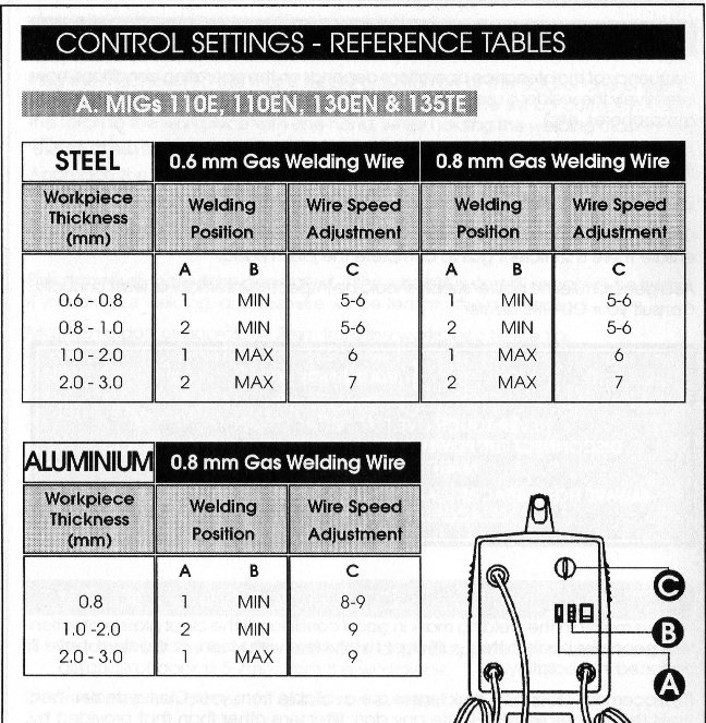

I have some 8-10mm steel, but I think my welder says it will only do up to 5ish?

Yeh.....2-3mm is about the best to learn on as you can sse the penetration levels, if your wacking to much power in etc.
What settings is your wire speed on? (its should be around 6ish)

Judging by your reply, it sounds like the shield gas flow is to low and your power may also be low (note, CO2 only shield gas does create a slightly deeper weld penetration).
Remind me what the power settings on the clarke are!
It was whatever the guide said, think it was prety much pointing up, maybe a shade faster
