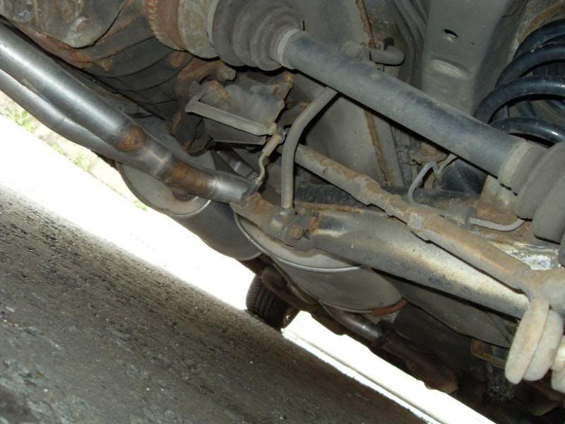

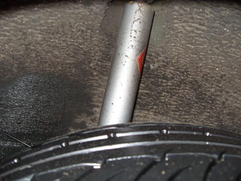

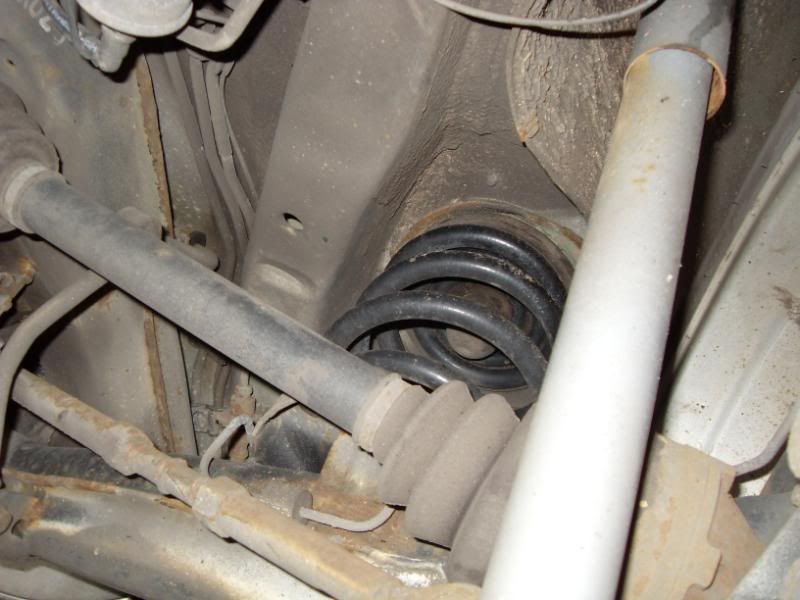

you guys were correct with rear suspension,looks like its got standard new shocks and springs,check how high the rear is?
im not fussed on having the self leveling as i wont be towing anything,would lowering springs for the rear sort this?

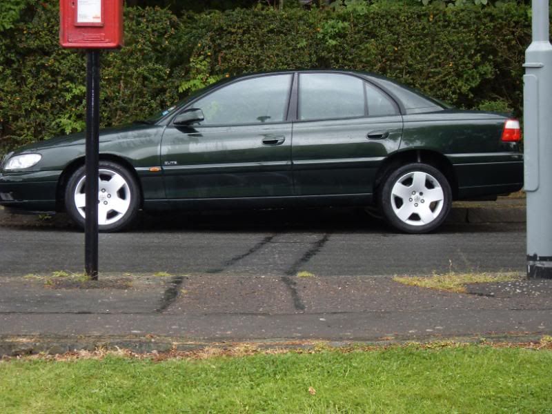

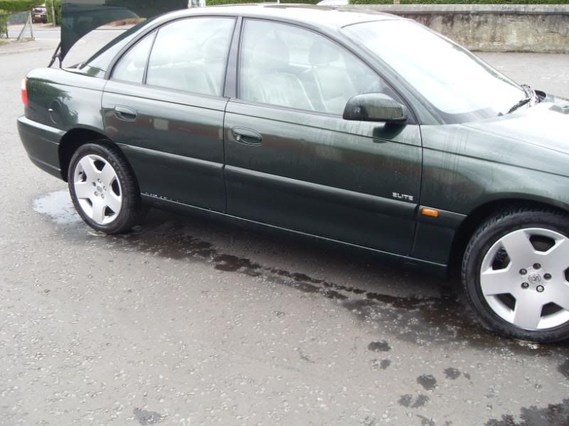

the car actually looks like its jacked up in that last pic

Jeeeeeeez !   Sorry dude..that suspension is just wrong...badly so !   Hopefully advice will be along soon. The front looks rather low for the "normal" Elite.
Mine is the same year as yours. I wonder, like mine whether yours has been fitted with the MV6 suspension setup but until the arse end is sorted, you're not gonna know. It MAY be possible that if yours HAS got the MV6 suspension and the rear shocks were changed, that the garage assumed yours was a "normal" Elite and fitted the wrong ones without checking properly.
Equally !  I wonder if your self levelling has gone bonkers and jacked up the rear end in error.
Best of luck..

The more I look at the front end, the more I'm convinced you have MV6 suspension. If so, ground to centre of the wheel arch, above the tyre, should be about 640mm.
The rear rises when you're pointing down hill it would appear but the pictures you took seem to suggest you're virtually level.

hi thanks il check,surely it cant be the leveling thats caused it,with it not having the leveling dampers?
il try source a pair of mv6 rear springs
whos best to get them from,what is this trade card thing?
cheers

Lol, they are estate rear springs!
The shocks are fitted wrongly to as the bush you can see should be in the trailing arm

« Reply #6 on: 01 June 2010, 20:58:29 »
i hope thats the only problem then mate thanks for the info
how can you tell they are estate ones just looking at a pic?
  • Posts: 34170
Re: my new omega elite (pics and problems)
« Reply #7 on: 01 June 2010, 20:59:17 »
Uber fat coils.

« Reply #8 on: 01 June 2010, 21:04:36 »
is it easy enough to do the back springs?

right i see
  • Posts: 34170
« Reply #10 on: 01 June 2010, 21:05:24 »
Dead easy, info in the maintenance guides

« Reply #11 on: 03 June 2010, 20:53:57 »
will update another pic but got proper saloon springs on it today
the mechanic said the estate springs were about 4 in longer and a nightmare to get out,car must of been properly stripped to fit these estate springs
just glad its sitting proper now
