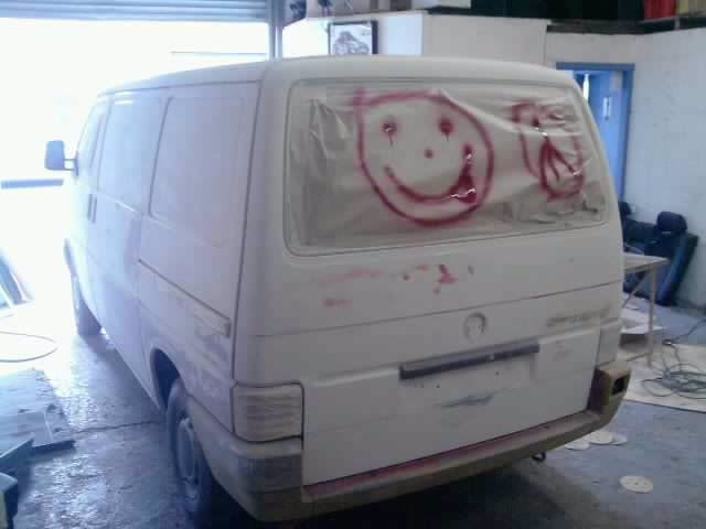

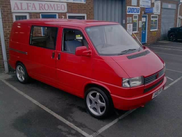

well, not put much on here, being its not an omega, but we took on a T4 pannel van 8 days ago,   8 days later, it is a full camper van with windows, tornado red paintwork, a visual / audio ICE instal, cookers, sinks, flooring, walls, Merc AMG SL55 AMG alloys with 4 undersized tyres, lowered etc...

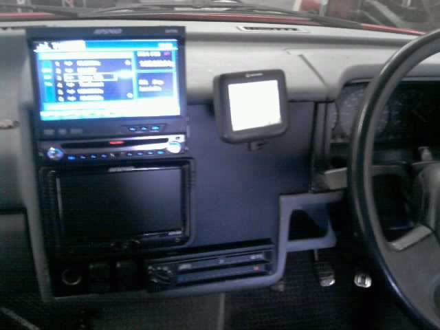

we built a custom dash to house everything, including a second monitor for the reversing camera
(yes, being a dum ass i bought a unit that didnt have a camera or video input hense used an extra screen!) looks good though.

nope, the rears are 9 1/2  fronts are 8 1/2  changed rears from 285 35 18 to 265 35 18 just clears (3mm).
the bore is different,  62 and i wanted 57.1  someone on fleabay had the plastic spiggot rings for £15 delivered, fitted straight in!
amazing look!
wheels from a £120k merc sl55  on a 1991 van!
