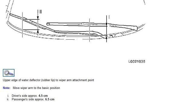

  • Posts: 34155
Re: Corsa D wiper problem
« Reply #5 on: 10 September 2010, 21:16:21 »
This is all I can find:
  • Posts: 9925
    • 530D M Sport, 330i Coupe
« Reply #6 on: 10 September 2010, 21:21:56 »
Thanks, looks like the position for the drivers side would be the same in reverse for RHD.
So i'll check that tomorrow.
I'm not sure why there are two different wiper lengths listed.
