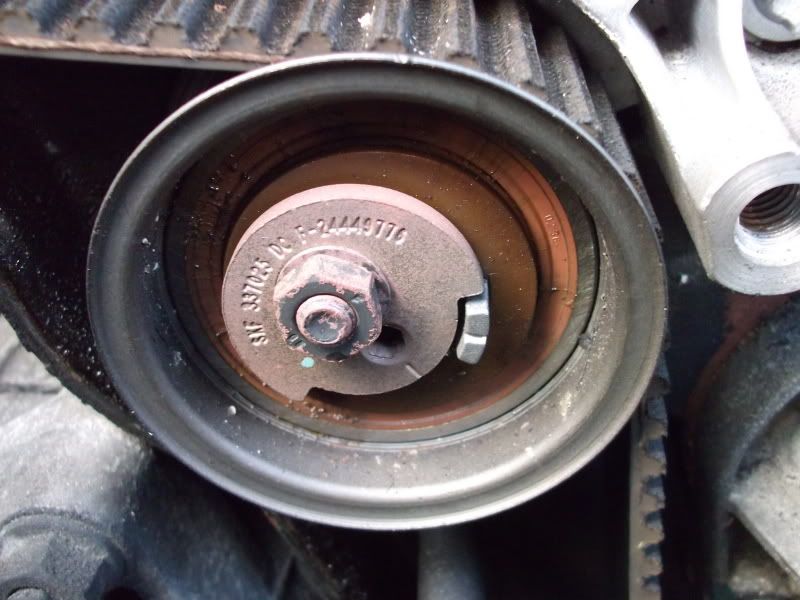

Did the cambelt kit, on the 3.2 MV6 today.
As you can see, the 1-3-5 bank was a little retarded:
And - the tension certainly wasn't "within limits".... :D
Now corrected -
New Cambelt Kit
New Water Pump
New Aux belt wheel
New Aux belt
5litres Longlife coolant
All set up correctly using the kit...
All Genuine GM components... £238 lighter, but much happier it's done!!

I would guess that the last change was done without the correct kit ;) ;)
Re: Do you think my cambelt needed changing?
« Reply #2 on: 06 March 2011, 20:43:03 »
Yes, looks like it was one of those tyre/clutch type outfits...
It's all good now, though! :D

Needed changing - Who knows
Needed setting up correctly - Definately!
