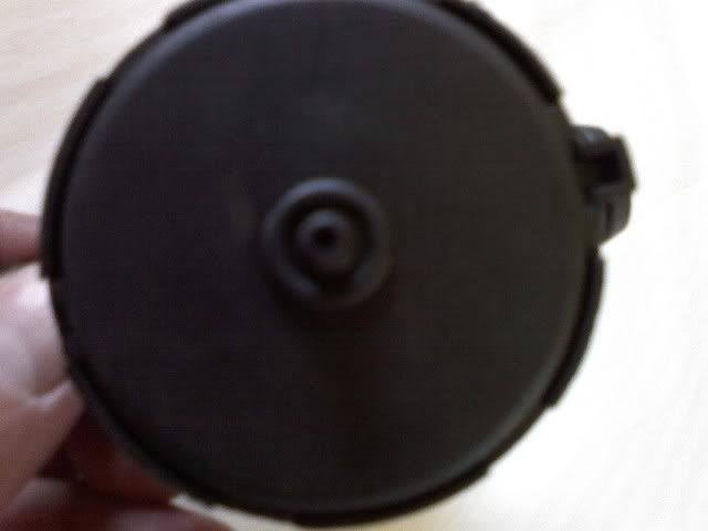

This is a pic of the HBV bought from Vauxhall four weeks ago which failed less than three weeks later.
(Sorry about the quality, I took them on my phone).

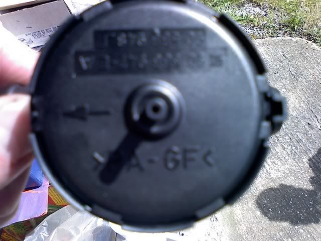

& this is one Timbuk & myself fitted this morning.

Is that Timbuks shadow to the bottom right of the last picture ::)
Your powers of deduction are amazing Sherlock!  ;D

Now how did I know that ;D

doesn't look like a genuine part, unless they've revised it.
I had probs with one that looked like that, too  :'(

Had a good look around this time, took inlet off to check bridge and hose to HBV, all seem ok so it looks like it was a dodgy HBV. Looks like the dealer is selling non genuine HBV's  >:( The one Bo Bo got a few weeks ago was in a plastic bag and not in the GM box as was the one i bought yesterday. I do believe Mr Bo Bo is going to make a complaint tomorrow  ;)

Well I finally got round to taking the HBV back to Vx yesterday  ::) & of course without the receipt they wouldn't even entertain me  :(
After a bit of moaning I managed to get 5ltrs of coolant for £8.50 rather than £11.60  :)

My two local Vx dealers sometimes fits non-Vx items, mainly pads, discs, and pad wear sensor. Apparently they are allowed to this (the car was even still under warranty). But at least the invoice stated clearly that the parts were non-Vx, although they did not warn me about this in advance.
But when you buy spare parts, that depends... if you just spesify 'HBV Valve', then I guess they can give you whatever they have... on the other hand if you specify the Vx P/N and got a non-Vx one, this is clearly out of order.
