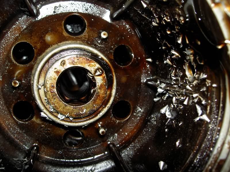

tea break.....heres where i am currently at....
Lid of filter off and filter out and picture taken up and into the filter...what you see in the picture far right is shrapnel from cutting into filter.
Looking at it i am concerned about where/ how the 27mm will fit on and grip......

Its one of the rare hex drive ones....you can see the hex in the centre....
Markie
  • Lanarkshire, Scotland
  • Posts: 7762
    • RS4, BMW X5, Range Rover
Re: Removal of Oil Filter Housing
« Reply #22 on: 04 February 2007, 16:08:32 »
yup!! as i dont have a 27mm socket but do have an excellent hex set ive tried the t55 and ....
Bingo ! its off with lots of swearing  :y
