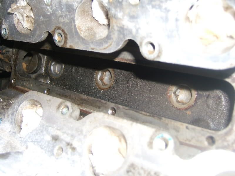

the cleaning up process....note that although the mating face looks dirty its smooth, clean and flush.
More cleaning rquired or does this seem ok?

« Reply #2 on: 12 March 2007, 16:47:56 »
I would clean the mating faces of block and cooler plate with cellulose thinners, white spirit can be a bit oily.
Apply copper grease to cooler threads.
Place the new cooler in the block with its O rings on.
Apply sealant to the groove in the cover plate, use a 3-4mm bead, make sure it is continuous, especially around bolt holes. Warm sealant tube first to make it easier to apply.
Lower cover plate on to cooler, it has to go in at an angle to clear the heads, locate over cooler threads then fit the cover bolts finger tight.
Fit cooler nuts hand tight to lift cooler into position under plate.
Torque up cover bolts.
Torque up cooler nuts.
You can use the spare oil cooler sealant on the thermostat housing but check it carefully first for cracks. You will need 2 new O rings for the thermostat bridge pipe.
Check the temp gauge connector for corrosion when you refit, the wire can become green and furry in the crimp and can fail after being disturbed.

Thanks Matchless - ran out of time to get any more done - will give another clean and need to get the o rings for housing as well.
Appreciate your help  :y

Looks good to go......Matchless has covered the main points.....
