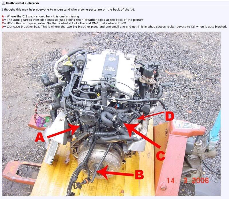

If you are 100% its not the bypass valve (it probably is, though....) then try and check out the remaining pipework at the rear of the engine.  A hose could have a pinhole or a weep from a hoseclip.
heres a piccy of the rear of the engine.  Not the greatest, grant you, but will allow you to suss out whats what?
HtH
B

I see what you mean its got to be either valve or longer pipe which goes under plenum. What does this pipe connect to but been a few weeks since plenum was off when I looked for leak first time. Just order and change both as precaution I suppose. Any idea if HBV is sold with Trade Card discount or full price at Vauxhall.

At this stage did not want to remove coolent bridge but suspect leak might be below it somewhere any body had leak from similar area was wondering whats below there. I presume thermastat and connection from heater but cannot find any pictures. All back together now as need to use car will check under car after its had a run and dried off water spillage.

The great big stainless steel coolant pipe enters the engine block just above the gearbox. That has an O-ring seal. Someone had the rubber pipe that comes off it split.
You need to get under the car and hug the gearbox and you will be able to feel the coolant pipe and hoses.
JasonH
  • Posts: 1110
Re: Another
« Reply #10 on: 26 April 2007, 23:09:04 »
Here's a pic of the pipe with the gearbox removed. It has a Y on it that doesn't show in the picture but is just an inch or two from the flange.
