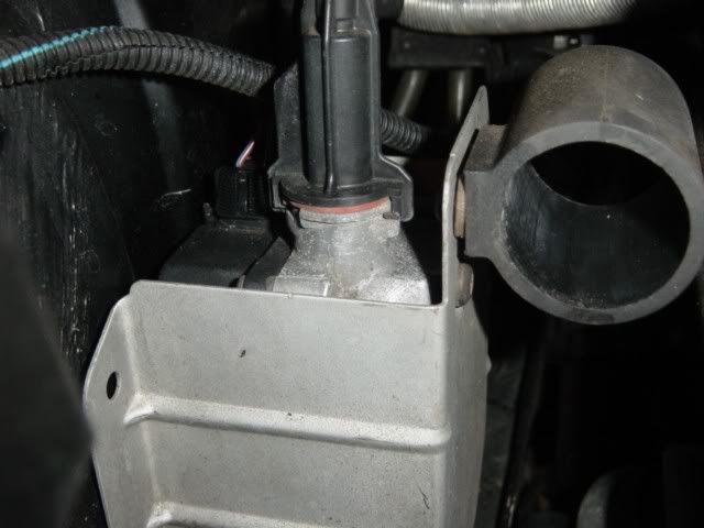

OK, thanks for your help. In the how to, it shows a rubber pump holder which has been attached to the cruise actuator bracket:
And in the desription it is mentioned that holes need to be drilled etc, but the actual rubber bit is different to mine, mine's like the standard one in this picture:
So there must be another part somewhere, as I'm not sure how I could mangle mine to get it how I'd need it. Not sure I'd want to either!
Cheers.

I used the existing pump bracket and bent it into a Z shape so that the pump clears the air box. Not as neat as getting the proper rubber mount but it works.

« Reply #5 on: 09 May 2007, 10:17:25 »
Trying to get my head around what you've actually done there! Have you just bent the existing bends even more? Looks alright to me, may try and get a spare first in case I bodge it.

« Reply #7 on: 09 May 2007, 19:48:38 »
Thanks!
Yes I've just bent it a bit more. I bolted the top front hole in the pump bracket to the top unused hole in the cruise module bracket and then fitted the cruise module but the bottom pump bracket hole went over stud that the font bottom cruise module bracket fits on. I tried with the read hole in the pump bracket first but the pump was too near the engine and pipes. I had to bend both of the existing bends to make sure the pump didn't foul the engine or the air box and to give clearance for the power connector near the cruise module.
Some more pics at the link below, pic0022 to 0025, the first two were from my first attempt and the second two show it as it is now.
