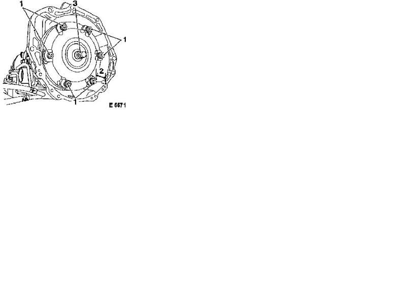

Ok
First off......is the box in neutral.....
1) Check ths spiggot bearing on the crank end is empty.....apply a small amount of grease to the inside face...
2) Check seating for torque converter on fluid pump shaft – Dimension "2" = 15 mm.
3) Check free movement of threaded bores (1) in torque converter.
4) Check centring journal (3) of torque converter for frictional rust and lubricate.
