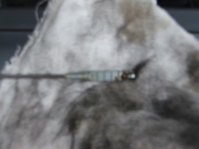

Oil up to the first notch, and oil from  the fourth notch up, will take a pic in the morning and post it up, the nothces in between nothing?, I keep assuming it is catching oil as I put it back in or take it back out?

Just checked the oil this morning got a better reading as engine was still a bit warm last night, oil up to the second notch only.
apologies for picture quality, batteries on camera ran out :-X
