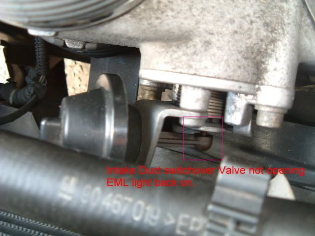

This was fixed at the Newent meet and solved the EML light, EML now back on as of this afternoon, checked the switchover valve and not working, have'nt tried any WD40 as yet, but should it be replaced?

For EML to be on, must be electrical. Connector still on the solenoid?
All connections to solenoid are fine, e.g., still connected.
No sign of a broken/chaffed wire, or corrosion in the plug?

« Reply #4 on: 05 September 2007, 19:44:24 »
I don't remember plugging in your car - did Mark do it? Did he say what error code was?
Yeah Mark plugged in, and stuck a pressure thingy on one of the small plastic pipes, then found the problem with the valve.
Need to check that tomorrow in the light ::)
