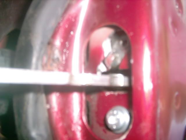

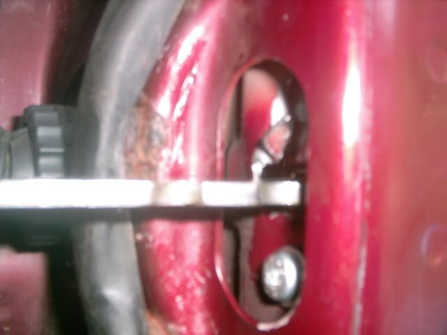

« Reply #15 on: 08 September 2007, 00:44:31 »
Can be repaired by the method outlined above if caught early enough
Anyone that heard mine at the Not Wales Meet will know how bad it can get. I fear mine may now be past the "two plate" repair as there now is no noise but no restraint either & it was fine a few weeks ago....
davlad22
  • Sunny Yorkshire
  • Posts: 1170
Re: drivers door
« Reply #16 on: 09 September 2007, 09:03:00 »
Closest it needs is the plates get a quick spray with a rattle can of the paint that is closest colour to your car before bolting it all together.   ::)
I don't really think you can see it so wouldn't even bother  ;D
  • Posts: 108243
Re: drivers door
« Reply #17 on: 09 September 2007, 10:14:32 »
Maybe not, but is does protect the metal from the elements, and should hold back any rust forming for a while...
megaomega123
  • Posts: 915
Re: drivers door
« Reply #18 on: 09 September 2007, 13:47:49 »
Mine had just the strap, no mechanism. Also the top had been ripped out leaving nothing for the bolt to go through. A replacement mechanism and a reinforcement plate on the outer solved the problem, oh and a new bush.
