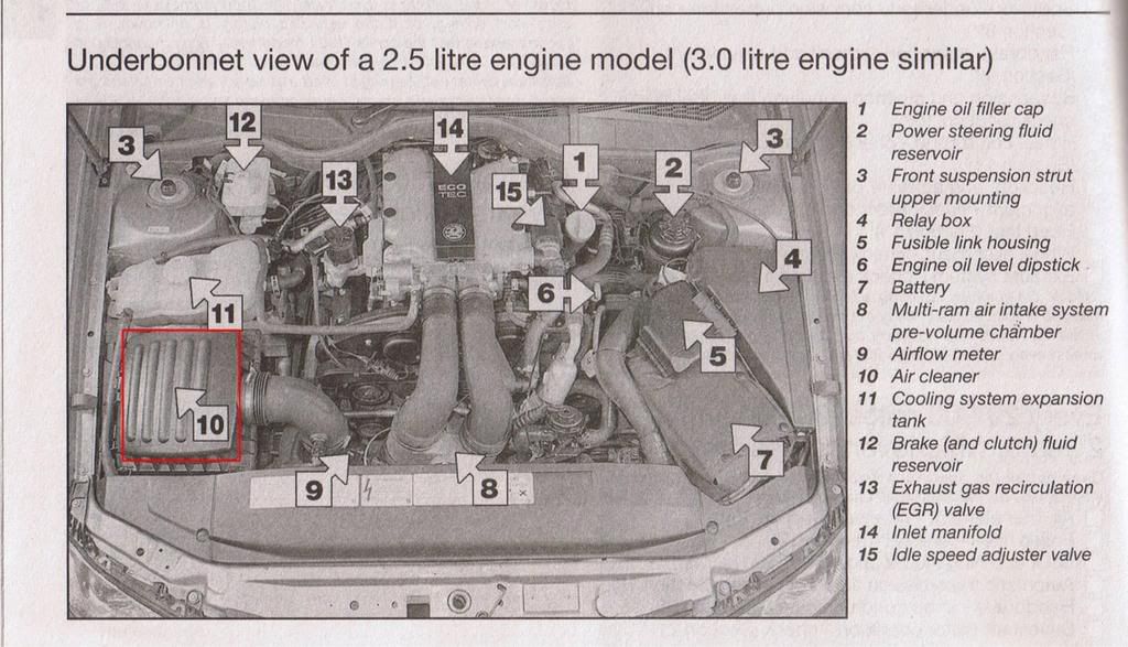

Okay - EVERYBODY is gonna laugh at me for being the most Stupid person on here
i have ordered a K&N Air Filter, where actually will i find the old one im to replace on my car?
i have a 1998 S Registration Vauxhall Omega CDX V6 Estate
i found a filter, but not sure if its the pollen filter or air filter
its located on the passenger side just below the windscreen, clips in either side
have i ordered an Air Filter and mistaken a Pollen Filter? ha ha ha
does anyone have pictures of where im to look?
i had a HAYNES manual but lost the damm thing in my loft, the bogie man has stolen it! lol

The filter under the windscreen is the cabin filter.  The air filter is on the front left hand side of the engine bay  (click link to photo)
http://i240.photobucket.com/albums/ff22/nuclear_onion/CCF13092007_00000.jpg
Hope that helps :)

Hi Wayne
You will find the Air Filter on the left hand side of the engine bay its on the drivers side at the front on the engine in a black ribbed box. There should be 4 clips that you unhook and that will open the box Filter in inside.
Hope that helps :y
P.S the one you where looking at is the pollan filter.

thanks chaps!
found them, just checked my AIR FILTER and it was extremely clean! damm!!
wasted £38 on a K&N Filter! oh well, i will put that in anyway
