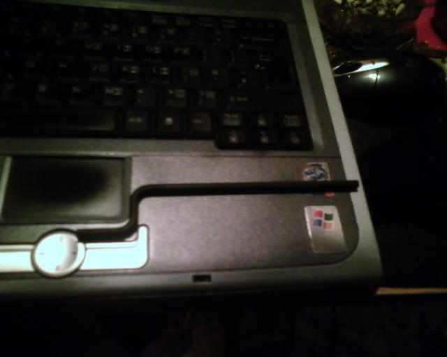

I think the seat winding handle is for just that purpose.
Mine was in the toolkit when I bought the car.
What is one of those !! Never seen one all my "toolkit" has is a jack and wheelbrace ... wonder if the seat sellers car has the tool ....  :)
One of these mate, sorry about the phone cam picture.
