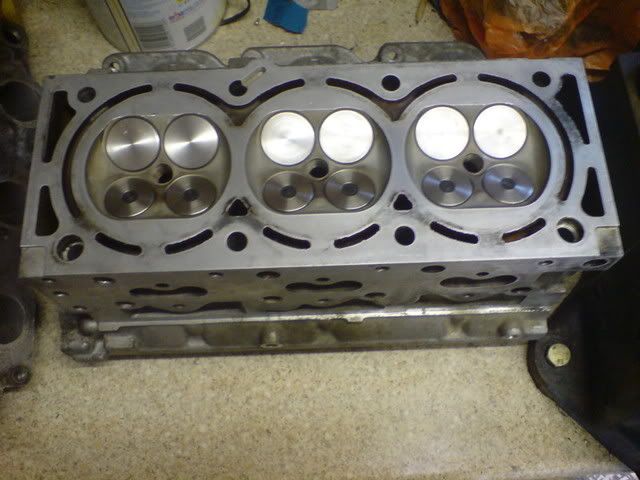

The crank case would pressurise almost immediately after startup and there is no Vx procedure for cleaning the breathers but.....we have one here  :y
http://www.omegaowners.com/forum/YaBB.pl?num=1152598350
As for the headgasket....have a look at this picture of a head:
The slots around the combustion bowls are water ways.....the larger holes on the right and left side are also water ways and the smaller ones on the left and right are oil return ways......
The bottom line is that the headgasket would have to fail past the water ways first before oil can affectively be pressurised by this route.....this you would definately notice!
And the high pressure oil feed, you can just see this small item in the form of a small milled groove at the top of the head....miles from anything.
Its a very bad bit of diagnosis this head gasket failure.....
As a quick test, pull a plug lead out and have a look for oil in the plug well.
The slots around the combustion bowls are water ways.....the larger holes on the right side are also water ways and the ones on the left are oil return ways......
Excellent description :y, though can you explain more about high pressure oil feed - does it go up that head bolt then?

Yup, comes out of the block gallery, along that slot and up the head bolt into the T vent/gallery.

Thats to much loss for a bent cover IMO....a half moon not fitted, now thats different!
Remember the old rule, find it, fix it......changes based on possibles without evidence = more unknowns.
« Last Edit: 10 March 2008, 15:05:08 by Mark »
  • Posts: 107615
Re: Cylinder head gasket change & oil leak
« Reply #13 on: 10 March 2008, 15:09:11 »
Good advice. Wish I'd followed it before swapping an engine over last summer.  Actually, I don't as well all had a bloody good laugh ;D
