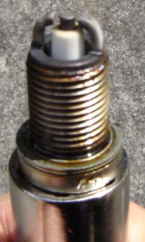

this spark done around 2 k mile
a lettel bit oil around the body
but nt on top
here the pic
what u think ?

Looks more like oil in the plug well rather than being burnt, IMHO....

It means the engine is not burning oil, there maybe a little oil in the hole the plug goes in

Oil leaking into the spark plug well. Probably from camshaft cover gasket.

Is the whole of the top of the plug covered in oil? If its just a tiny amount I wouldn't worry about it

It is a VERY good thing if your engine is not burning oil so nothing bad will happen :y :y.
However, oil around the top of the plug means either a leak from your cam covers or you have spilt oil (or somebody else has) onto the top of the engine.  Are any other plugs so affected?
I recommend you wipe clean all the holes and then see if oil forms again around the top of the plugs.  ;)  If it does you do have a small leak somewhere.

Is the oil above 'max' on the dipstick?  If it is by a fair degree, drain some oil off as you should never exceed this limit.
If you recently filled up your engine with oil, then once more I would recommend that you clean out all the plug holes and see if oil re-appears.  If it does then it will be the cam covers.  But eliminate the SIMPLE possible reasons first! ;)

That looks like a perfectly normal plug to me. It's normal to get a little oily deposit on the thread. If there was oil in the plug well before the plug was removed than it's likely the cam cover gasket needs attention but other than that nothing to worry about.
