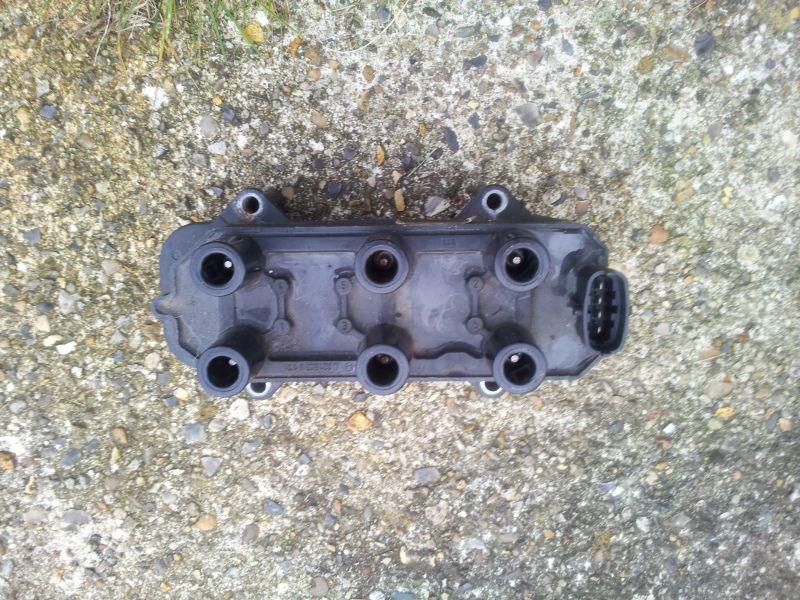

This is the one off my '98 2.5:

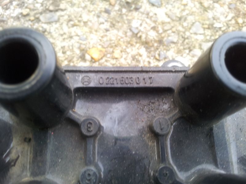

The only part number I could find on it is on the top between pins one and three:
The number reads 0221503017
HTH.

That number is a Bosch part number, and any motor factor will be able to cross it to whatever supplier they use. As will Google, or probably Ebay.
