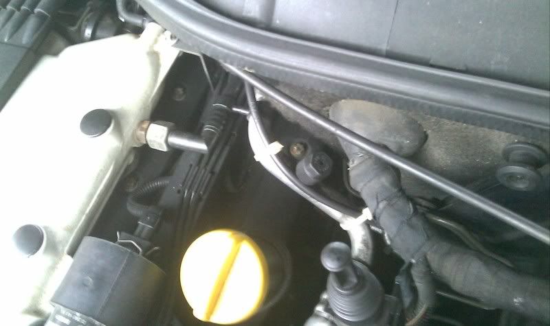

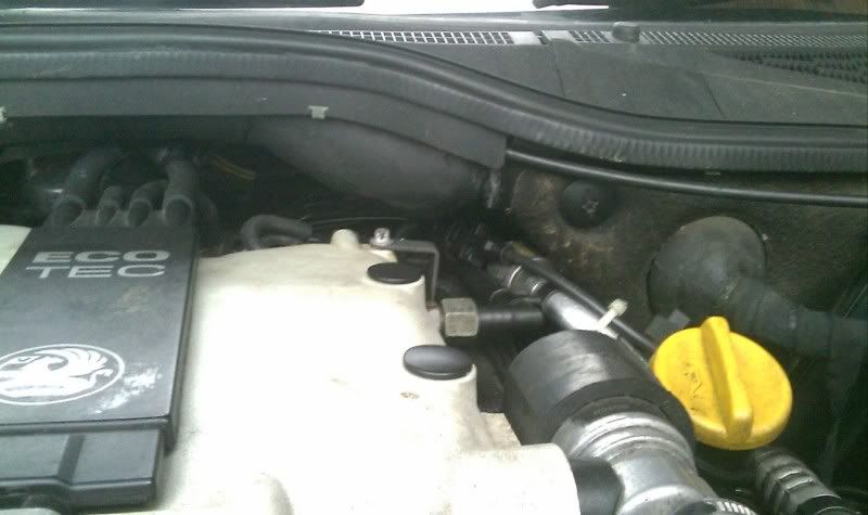

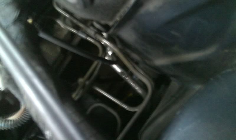

CaptainZok
  • Bolton
  • Posts: 8093
  • Victim of Cyberbullying.
    • 3.2 MV6 Estate
Re: Crank Sensor..!!
« Reply #7 on: 01 July 2010, 18:34:58 »
Plug pulled forward.
Cable tied to aircon pipe.
Passed dowh behind brake pipes.
Just make sure the cable is as far away from the hot downpipes as possible and you should be ok.
TuBy's new whipping boy.
