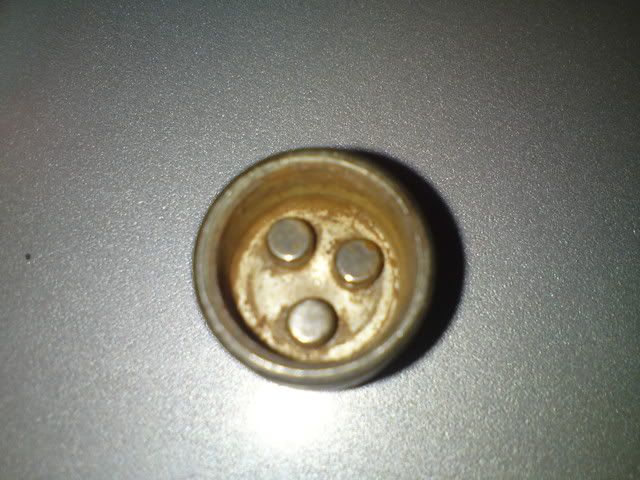

Hopefully, the same as mine then.  I'll go get a pic of the key. See if it looks like the pattern on your wheel bolts.  Back in a few minutes.

« Reply #4 on: 16 September 2010, 20:45:31 »

The other type has a (I think) 8 pointed star.  It also has a collar which rotates so undoing them without the key is quite a bit more difficult.

Doesn't appear to have a rotating collar on it, so buy yourself a socket which will fit on with the help of a hammer and you'll be able to undo them (provided they havent been done up by a Gorilla with an Air-Gun set to full-tilt.

If it's the 3-pronged key type (which secures the wheel bolt cover plate), I replaced mine with M8 x 1cm stainless steel Allen key bolts.
Removed the originally-fitted bolts by giving a cold-chisel a sharp tap with a hammer.
Looks better too! :y
