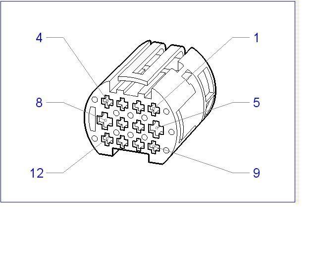

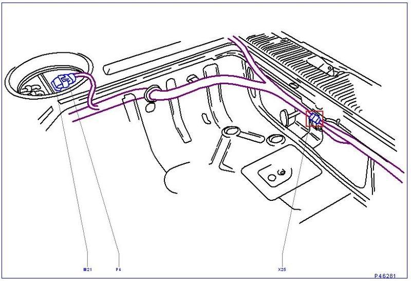

Indicated by the red box
In a saloon (behind the plastic slam panel trim)
In an estate (spare wheel well)
Connector pinout
The permanent supply is rated upto 30amp and is on pin 8 (Red wire).
The fuse position is F5.....
