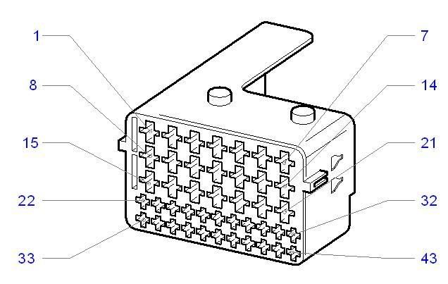

One is blue, one green
Which connector carries the fog lights and which pin is it?
2001 2.6 Facelift
Thanks

Its the one nearest the front of the car....X8
Pin 28 - Black/Blue Wire

I think I tested that one as 0v - so I'll recheck it later
Worst case will be another lead from fuse box to that connector
